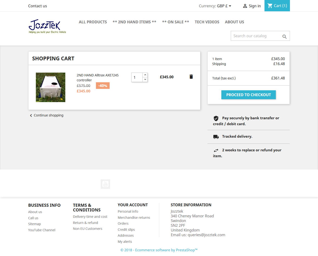

Polgara Posted September 14, 2018 Author Share Posted September 14, 2018 Actually even the "quickview" does not work anymore : https://www.jozztek.com/helping-you-build-your-electric-vehicle/13-ebike-controllers So it is all the javascript / ajax that's bugging. Since restoring to a previous database backup from when it used to work did not solve it, could it be that my files are corrupted ? Can I upload them back to my server reusing my current database smoothly, so I don't loose everything ? If I have to reinstall it once more, do you know when the 1.7.5.0 will be realised, so at least I get the latest one ? Thanks in advance for any help. Link to comment Share on other sites More sharing options...
dinesh badrukhiya Posted September 15, 2018 Share Posted September 15, 2018 10 hours ago, Polgara said: Actually even the "quickview" does not work anymore : https://www.jozztek.com/helping-you-build-your-electric-vehicle/13-ebike-controllers So it is all the javascript / ajax that's bugging. Since restoring to a previous database backup from when it used to work did not solve it, could it be that my files are corrupted ? Can I upload them back to my server reusing my current database smoothly, so I don't loose everything ? If I have to reinstall it once more, do you know when the 1.7.5.0 will be realised, so at least I get the latest one ? Thanks in advance for any help. I think Prestashop 1.7.5 will be release in october month. I checked URL shared by you and found no issue with add to cart. Link to comment Share on other sites More sharing options...
Polgara Posted September 15, 2018 Author Share Posted September 15, 2018 Hi dinesh badrukhiya, Thanks for taking the time to check it out. Yes, you are right, it got magically solved overnight. I think the main issue must have something to do with the memory used, because it is like when I try to log in : in only works one time out of three. Most of the time it freezes... Hope the 1.7.5 version takes that king of issue into account. Link to comment Share on other sites More sharing options...
