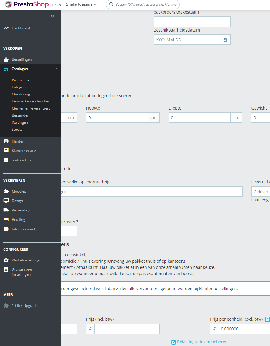

Seppe Posted December 1, 2020 Share Posted December 1, 2020 When I used 1-click upgrade to update my shop from version to 1.7.6.5 to 1.7.6.9, my backend is messed up. I can't even add products in a normal way Link to comment Share on other sites More sharing options...
