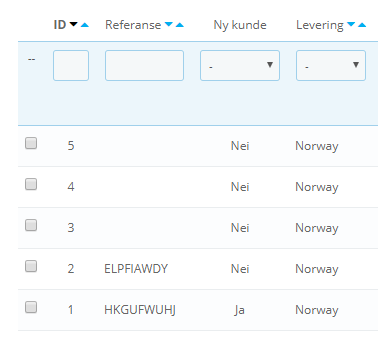

necrosaro420 Posted August 27, 2018 Share Posted August 27, 2018 I can't stand that when someone places an order, that it assigns random letters. I process orders in the order they come in, so it makes it pretty hard to organize with just a bunch of random letters. Is there a way, or module or something that will change the order number letters to actual numbers, as well as put them in order? Say First order is 21000, next that comes in is 21001, 21002, 21003 etc? Thanks Link to comment Share on other sites More sharing options...

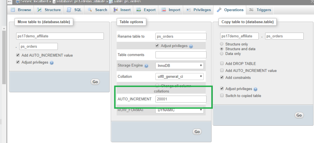

necrosaro420 Posted August 28, 2018 Author Share Posted August 28, 2018 Thanks. Is there a way to start it from a specific number then? Link to comment Share on other sites More sharing options...
Knowband Plugins Posted August 28, 2018 Share Posted August 28, 2018 To start it from the specific number, you need to reset the auto increment of the order table. Open the orders table from the phpMyAdmin, Go to Operations & set the autoincrement to the desired number as shown in below screenshot. 1 Link to comment Share on other sites More sharing options...
