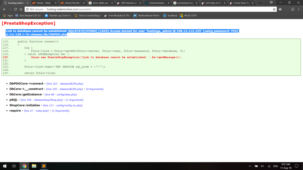

vimal Posted August 11, 2018 Share Posted August 11, 2018 Hi,, Please help me.. i successfully upload my prestashop 1.7 from local to remote Linux server , also upload the database to a new named database. after that i edit the parameters "parameters.php", but there is one error as bellow Link to database cannot be established: SQLSTATE[HY000] [1045] Access denied for user 'hostinga_admin'@'198.15.115.235' (using password: YES)at line 120 in file classes/db/DbPDO.php please help me to solve this issue as early as possible, i am running out of time now. Link to comment Share on other sites More sharing options...
Knowband Plugins Posted August 11, 2018 Share Posted August 11, 2018 Hi, Are you able to login into Database server using the same credentials which you have mentioned in the parameters.php file? Apart from, Can you please try after replacing DB host i.e. 198.15.115.235 to localhost? (Depends upon hosting). Also, delete the cache from the folder i.e. app/cache (All folders inside the cache folder) & check again. 1 Link to comment Share on other sites More sharing options...

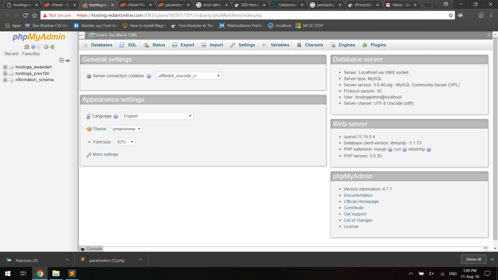

vimal Posted August 11, 2018 Author Share Posted August 11, 2018 (edited) this is my parameters file <?php return array ( 'parameters' => array ( 'database_host' => '198.15.115.235', 'database_port' => '3306', 'database_name' => 'hostinga_awawdeh', 'database_user' => 'hostinga_admin', 'database_password' => '***************', 'database_prefix' => 'ps_', 'database_engine' => 'InnoDB', 'mailer_transport' => 'smtp', 'mailer_host' => '198.15.115.235', 'mailer_user' => NULL, 'mailer_password' => NULL, 'secret' => '7NBAAvK3Arstsk3S1sKNr4RwAJygNJ40ImeR91Uu5ITrE2EKFPQGFu71', 'ps_caching' => 'CacheMemcache', 'ps_cache_enable' => false, 'ps_creation_date' => '2018-05-12', 'locale' => 'en-US', 'cookie_key' => 'ghG0prkkydpUkuIom3ckK0pJGtgzHJwgyWT9FQiqrrOm9H2oMX5drKWg', 'cookie_iv' => 'FsoiZEDT', 'new_cookie_key' => 'def000002a1b9f33e7a60be29e1052234bc519c2788983ff9f3deaa9d36125364f2b54d6a7acb6bd0006df9869ccc3777cf8b7606b571fa4ba8b5a2996e0dd2cece068c8', ), ); ?> this is my php myadmin window Edited August 11, 2018 by vimal (see edit history) Link to comment Share on other sites More sharing options...

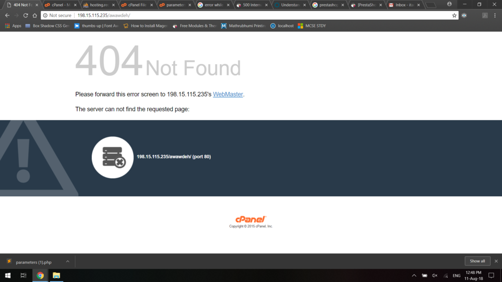

Knowband Plugins Posted August 12, 2018 Share Posted August 12, 2018 Hi, I tried to access the Site from the URL i.e. http://98.15.115.235/awawdeh but it's not accessible but while I tried to access your using the URL i.e. http://hosting.redantonline.com/awawdeh/en/ Its working fine. Kindly check. To access the site using the IP, you need to contact the hosting provider (It might be shared IP & you will not be able to access the site using the IP). Link to comment Share on other sites More sharing options...
