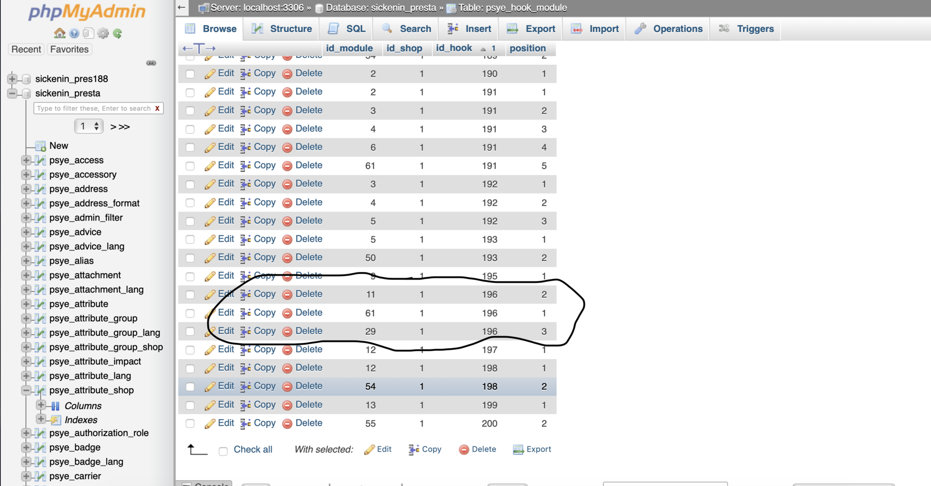

robotreid Posted April 6, 2019 Share Posted April 6, 2019 Great, that helps a lot! so I made these changes and made sure that my Paypal id_module was position 1 out of the 3 that were attached to the paymentOptions hook. however, the PayPal option is still not showing up. any other recommendations to try? as you can see in the photo, under my hook_module the paymentOptions is 196, and PayPal module is 61. Link to comment Share on other sites More sharing options...
cuddlydr Posted April 7, 2019 Share Posted April 7, 2019 I'd try to compare PayPal to Skrill or other payment module to find out if perhaps PayPal is missing in some other hooks. My intuition tells me that all payment modules should be in the same hooks so if you see Skrill somewhere but not PayPal then you need to add it. Of course you need to check the basics in BO as well, Payment Preferences must have PayPal assigned to currency, customer groups etc. Please don't take my advice as a gospel, I am mostly as confused as you, and not a developer at all, so my specific solutions may not work for you. Pity that PS forums lack help from more professional people especially with such a capricious software as Prestashop 1.7. 1 Link to comment Share on other sites More sharing options...
