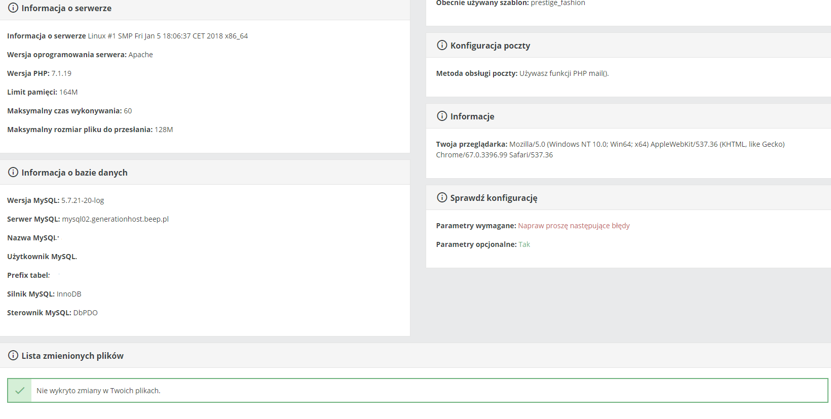

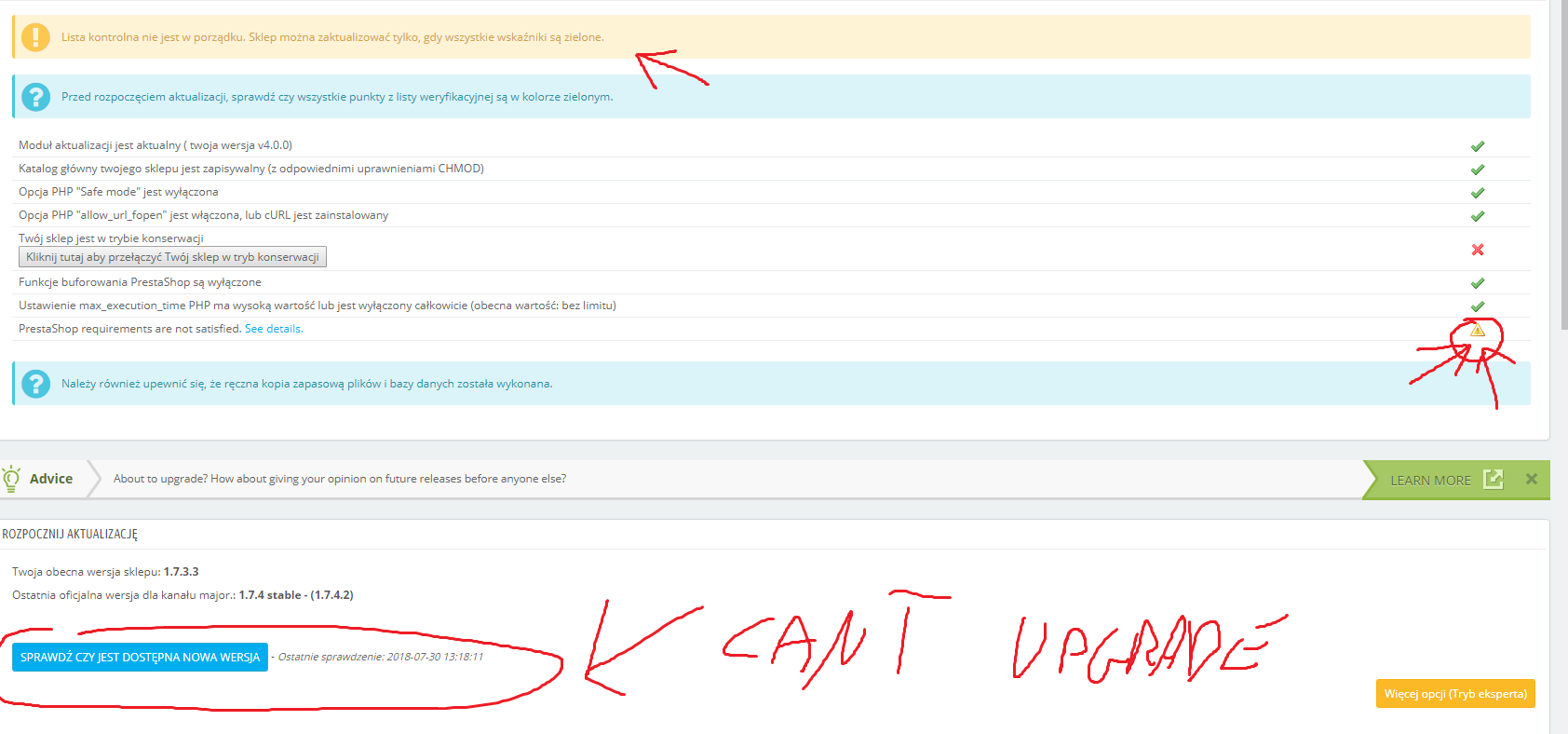

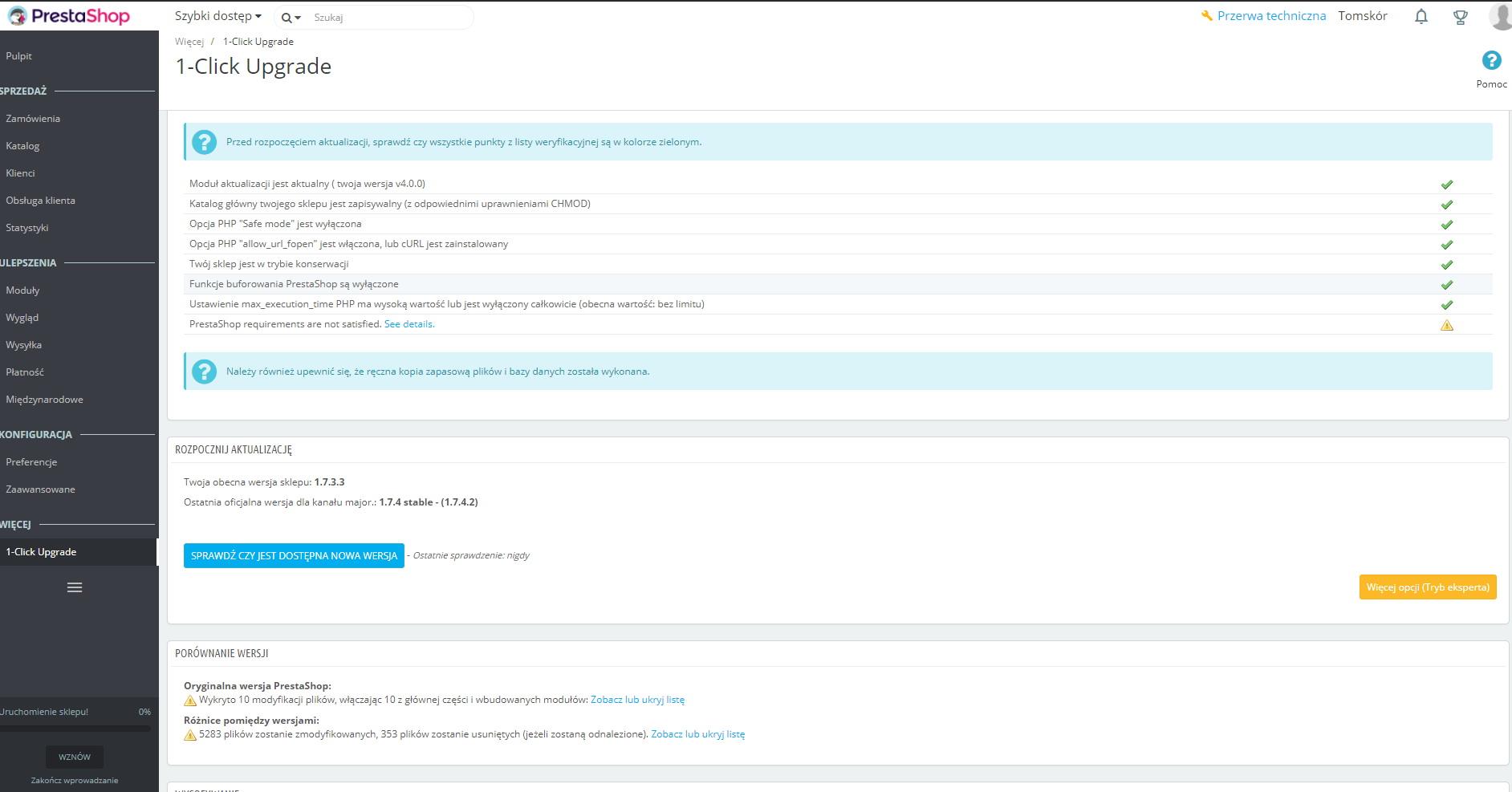

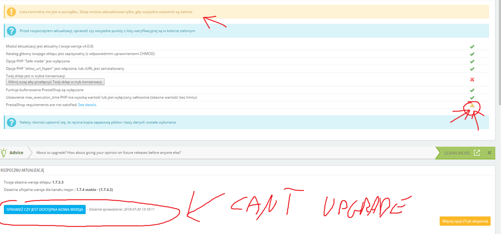

Tomskór Posted August 1, 2018 Share Posted August 1, 2018 (edited) Hi we, have problem with 1-click upgrade module. But first, we tryed to upgrade to 1.7.4.1v but had critical error and we must restore our backup and everything works fine, and we make a mirror of our store where we test updates. And relase 1.7.4.2 come out and first we trying to do this on our mirror and its work (this same serwer on subdomain) but when we tryed to upgrade main store, we have this issue. We check server configuration and everything is fine. And before update I trying to use classic theme, clear cashe from backoffice and manualy and disable SSL but nothing helps. Edited August 1, 2018 by Tomskór (see edit history) Link to comment Share on other sites More sharing options...

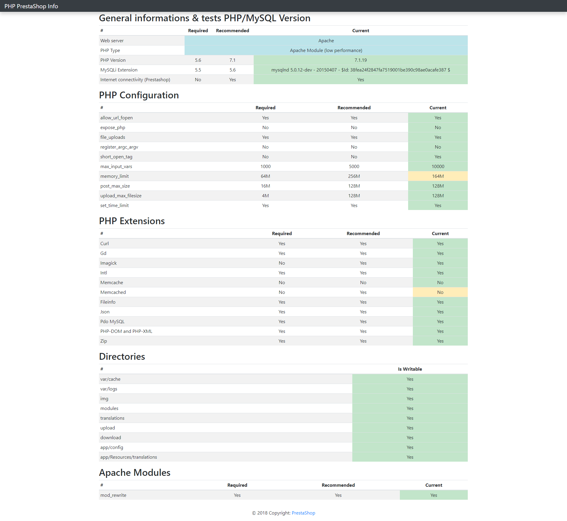

selectshop.at Posted August 1, 2018 Share Posted August 1, 2018 Your server does not fulfill min. requirements. See here requirements for PS 1.7.4.- https://www.prestashop.com/forums/topic/633857-server-requirements-for-ps-17/ Although you can use php 7.1. better you use php 7.2. Furthermore check also the limits of max_input, max_execution and memory_limit, which are too low on your server. Link to comment Share on other sites More sharing options...
Tomskór Posted August 2, 2018 Author Share Posted August 2, 2018 On 8/1/2018 at 2:49 PM, selectshop.at said: Your server does not fulfill min. requirements. See here requirements for PS 1.7.4.- https://www.prestashop.com/forums/topic/633857-server-requirements-for-ps-17/ Although you can use php 7.1. better you use php 7.2. Furthermore check also the limits of max_input, max_execution and memory_limit, which are too low on your server. Expand Thats not a problem, cuz on our mirror store from 1.7.4.1 we upgrade to 1.7.4.2 with any of this problems, and mirror is on this same serwer. On 8/1/2018 at 2:25 PM, aixos said: Hi you must follow step by step this link is in Spanish https://www.prestashop.com/forums/topic/873841-actualización-con-1-click-upgrade-desde-17-a-1742/ regards Expand Thanks, but we trying deinstall autoupgrade and install newest version, but thats not help. Still see LISTED NOT SATISFIED Link to comment Share on other sites More sharing options...

Tomskór Posted August 2, 2018 Author Share Posted August 2, 2018 We downgrade our mirror to 1.7.3.3 and same problem, cant upgrade to 1.7.4.2 cuz some files is modified and list are not satisfied so we back to the start. Link to comment Share on other sites More sharing options...

Tomskór Posted August 2, 2018 Author Share Posted August 2, 2018 (edited) On 8/2/2018 at 10:16 AM, ksaan said: If it works on your mirror and not on the main shop: - maybe your mirror is not 100% identical and the little difference is what makes the upgrade crash. Same modules installed ? same database ? same languages and themes installed ? - maybe you have so many customers and people coming on your website this makes the upgrade crash ? can you put yourself in maintenance mode, or even stronger: stop people from accessing the server ? - else you are very unlucky and you have a crazy bug that only happens on your shop, not on the mirror. You need a developer / an agence to look at the 2 shops and find the difference Expand Its worked once, now dosent. Mirror was 1:1 this same but we tested upgrade1.7.4.1v and later we upgrade to 1.7.4.2 what was possible, but when we restore 1.7.3.3v on mirror have this same issue and we cant upgrade to lasted relase. But we dont have any crash, nothing happend cuz I CANT CLICK UPGRADE PRESTA becouse have warning about list not satisfied so only option what I have its, CHECK FOR UPDATES Thats not a problem cuz mirror is on this same serwer with main store, and sometimes we have none users online on website. I think thats not a rare bug, maybe something change when we restore backup after crash, and presta have problem with some files. After all maybe we will must instal fresh 1.7.3.3 restore dB and theme and then trying to update, but I dont know there is some simple way to restore all data and customization on fresh presta. Edited August 2, 2018 by Tomskór (see edit history) Link to comment Share on other sites More sharing options...

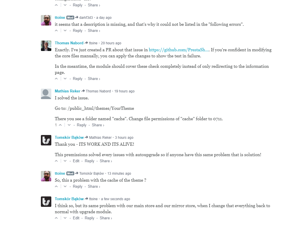

Tomskór Posted August 7, 2018 Author Share Posted August 7, 2018 Problem solved, issue was wrong premission with cashe folder on active theme, when we change it ITS WORK. Link to comment Share on other sites More sharing options...
Jontee Posted August 7, 2018 Share Posted August 7, 2018 Thanks! Which folder did you change, and to what permission? Best regards, Link to comment Share on other sites More sharing options...
Tomskór Posted August 7, 2018 Author Share Posted August 7, 2018 Everything you need is: http://build.prestashop.com/news/coreweekly-week-30-2018/ 2 Link to comment Share on other sites More sharing options...
satkauskas Posted September 11, 2018 Share Posted September 11, 2018 Tomskór, thank you. It solves the issue with upgrading from version 1.7.3.3 to newer ones. Great. Link to comment Share on other sites More sharing options...
