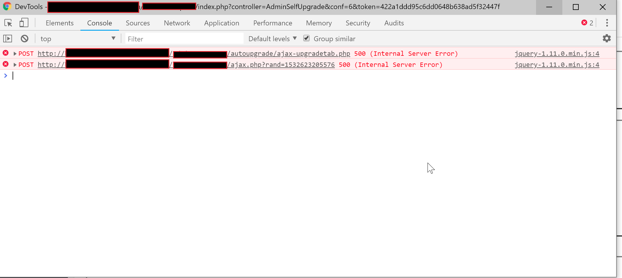

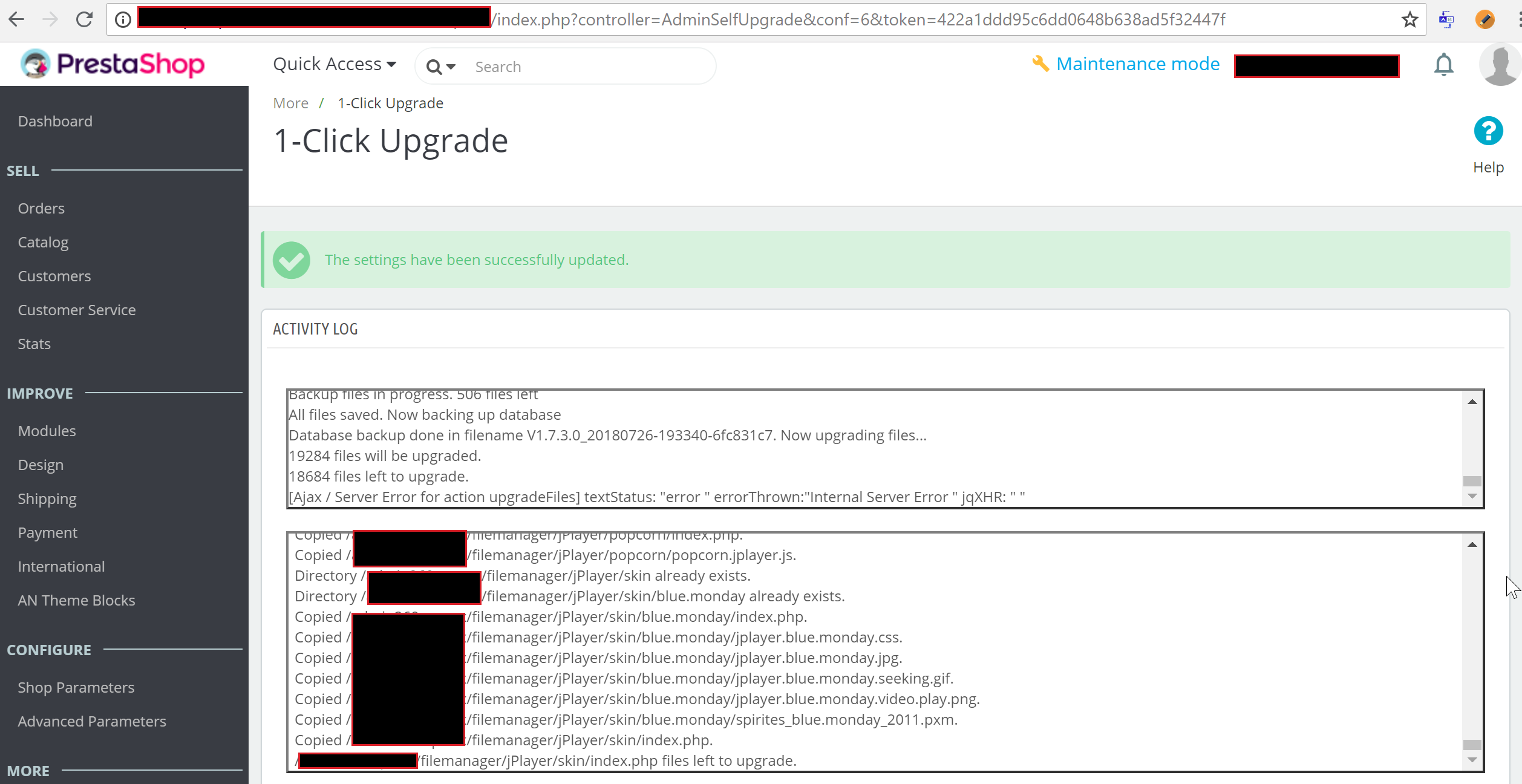

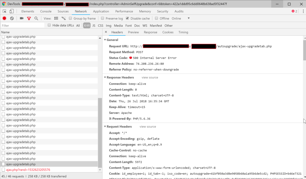

wutever0 Posted July 26, 2018 Share Posted July 26, 2018 Hi, I am using the latest 1-Click Upgrade module (v 3.0.5) When I try to upgrade my site from 1.7.3.0 to 1.7.4.1, it stops at the following point with the same message. I tried this twice with the same results. The whole site also becomes unaccessable and the only option is to manually restore the file backup. I have also attached Developer Tool Console output. Is anyone else facing this issue and is it a bug in the upgrade module? Regards Link to comment Share on other sites More sharing options...
