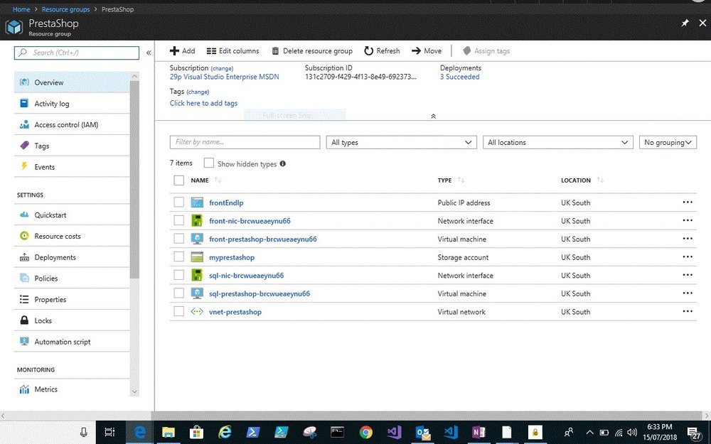

I have used the "PrestaShop Advanced Template" to automatically create my PrestaShop install of ( 1 Web Server & 1 Database Server).
However when I try to access the back office I get and error telling me I need to delete the /install directory first.
that would be fine except it was an automatic install so I don't know were the install folder is !

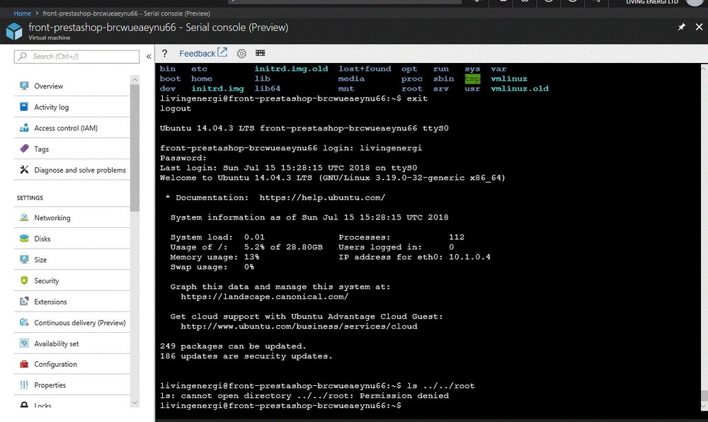

I have managed to fish around a bit and got onto the web server and executed the "ls" bash command to see folders,
I cant find the install folder,
however I don't have access to the /root folder and suspect that it might be in there.
I'm logged into the Azure Portal and I am using a "Serial Console" to access the Web Server (front-end VM)
I have also check on the database server (back-end VM) in the same way and have the same limited access.
I'm new to Bash, so how do I elevate my permissions so I can access the root folder [if indeed the /install folder is located there] ?

found the solution
need raised privileges which is achieve by using the "sudo" command before the desired command
such as:
sudo ls -a ../../root
or
sudo ls -a ../../var/www/html
this second command list the install directory amongst others
so
sudo rm -r ../../var/www/html/install
actually removes it.
