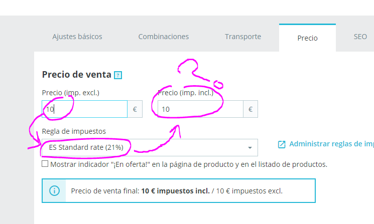

Antakarana Posted July 13, 2018 Share Posted July 13, 2018 (edited) Hi everybody We have detected a possible bug of prestashop... on a shop with PS 1.7.3.3 we have realized about the followint issue: On backoffice if you go to the price tab of any product page you will see that the prices are the same on both fields "taxes excluded" and "taxes included". No matter if you change one of them the other one changes at the same time. So for example if you go to the "taxes excluded" field and you set 10€ then on the "taxes included" field you should see "12,1€" (which is the result of 10€ + 21% tax) does anybody know what is happening with the price or how can we change that behaviour??? Thanks in advance Edited July 23, 2018 by Antakarana (see edit history) Link to comment Share on other sites More sharing options...

Antakarana Posted July 14, 2018 Author Share Posted July 14, 2018 hace 13 horas, rictools dijo: Check the configuration of the tax rate. Hi Thanks for the reply, however I already did that and everything is correct. The problem is that the standard tax rate (IVA 21%) has stopped working. No matter if I change the rate to other %... it always shows the prices like if it was set to 0%... However if I change the tax rule to another one then it updates the tax prices correctly. So the only way I have to fix it is to create a new tax rule for the IVA 21% and apply it to all the catalog. The problem is that I have to manually perform that change on every product (about 450 items) because there is no option to set a tax rule to all the catalog with a single click. Link to comment Share on other sites More sharing options...

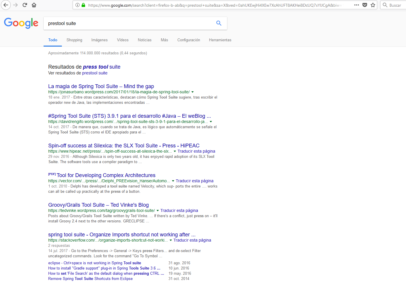

Antakarana Posted July 23, 2018 Author Share Posted July 23, 2018 En 17/7/2018 a las 6:45 PM, rictools dijo: When I write "prestools suite" it's "prestools suite" and not "prestool suite"! Sorry, you don't live on earth? You didn't ever heard about google? Search for "prestools" and you are there ... Or try the domain prestools.com ... It could not be easier ... Hi Before asking anybody for a link I try first to search it by myself, and of course that's what I did in that case... Unfortunately I commited the mistake of typing "prestool suite" on google instead of "prestools suite". If you do the same "misspeled search" you will realize that it doesn't show any useful link. That's the reason I asked you about the way to obtain that free tool. Anyway thanks for your help regards Link to comment Share on other sites More sharing options...
