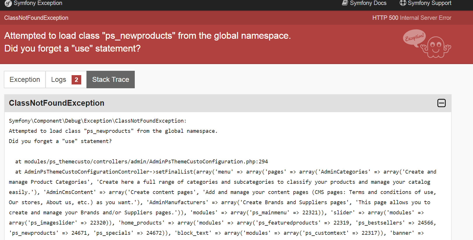

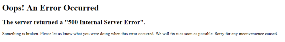

bronson732 Posted July 11, 2018 Share Posted July 11, 2018 Hi, when I try to click "Homepage Configuration" in order to change some settings, I get a "500 Internal Server Error". I already tried changing all file permissions to 755 but that didn't change anything. I attached some screenshots so you know what I'm talking about. If you need any additional logs, be it logs, screenshots, or technical details, please tell me. Best Regards D. Link to comment Share on other sites More sharing options...

ik0143 Posted July 12, 2018 Share Posted July 12, 2018 Maybe you should enable debug mode first to identify the issue. I have same problem as well and from debug mode, I can know some modules were not installed. After I installed missing modules, I can click "Homepage Configuration" without any error. Link to comment Share on other sites More sharing options...
bronson732 Posted July 12, 2018 Author Share Posted July 12, 2018 14 hours ago, ik0143 said: Maybe you should enable debug mode first to identify the issue. I have same problem as well and from debug mode, I can know some modules were not installed. After I installed missing modules, I can click "Homepage Configuration" without any error. 1 Thanks for your reply. I'll try this out tomorrow. Link to comment Share on other sites More sharing options...
bronson732 Posted July 13, 2018 Author Share Posted July 13, 2018 Turning on Debug Mode helped me to solve this. In the end, it was a module that required an upgrade. Thanks for your help and your patience! Link to comment Share on other sites More sharing options...
