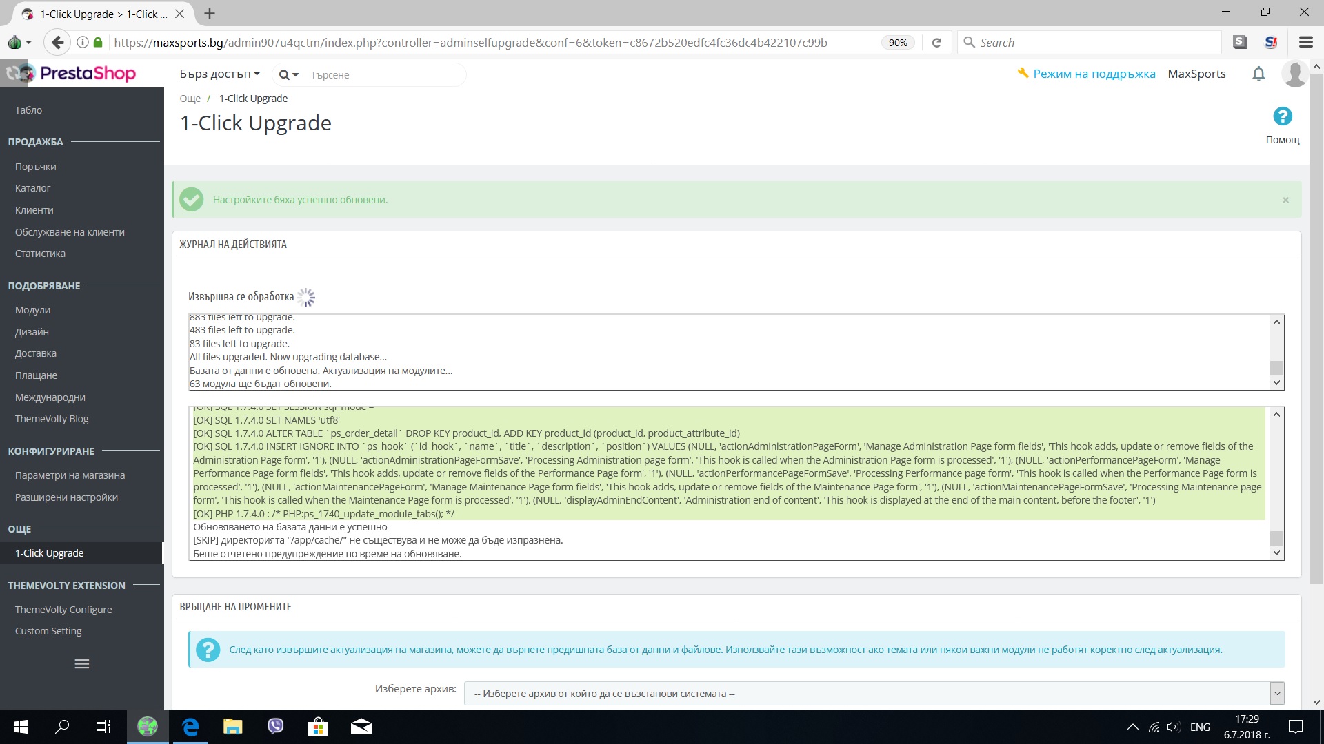

  On 7/5/2018 at 8:16 AM, barros77 said:
Hi,
i have solve the problem , i have donwload the click upgrade beta 4.0 and install them , after the upgrade dont give any error
thanks
Expand
Hello barros77 ,
Can you Please post a link of 1 click upgrade 4.0
Thank You
