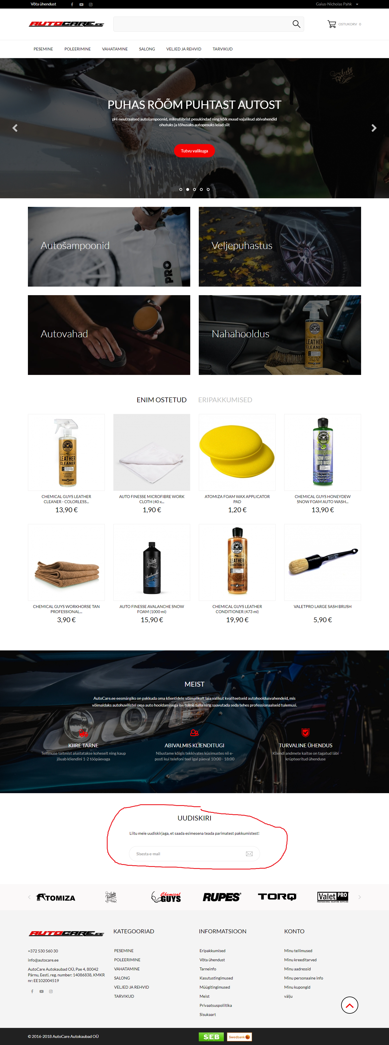

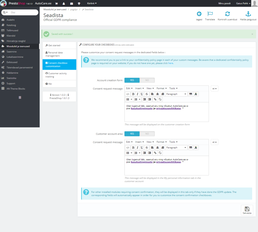

gaiuspahk Posted May 26, 2018 Share Posted May 26, 2018 Hi! Bough the Official GDPR Module for Prestashop 1.6, which should help me manage all other modules that require consent from users and so on. But the newsletter module doesn't show up there. I can't add a opt-in box from under the newsletter module (blocknewsletter) settings or the GDPR module settings. Link to comment Share on other sites More sharing options...

gaiuspahk Posted May 28, 2018 Author Share Posted May 28, 2018 40 minutes ago, bellini13 said: What gave you the impression that the "Official GDPR" module from Prestashop would help you manage "all other modules"? Addons: "Developed by the PrestaShop team with help from our GDPR experts, the Official GDPR Compliance module is the only one that offers you a solution adapted not only for your site that processes the personal data collected by the PrestaShop solution, but also the modules installed on your store." PrestaShop Developers forum: http://build.prestashop.com/howtos/module/how-to-make-your-module-compliant-with-prestashop-official-gdpr-compliance-module/ The module itself (backoffice view): "For other installed modules requiring consent confirmation, they will be displayed in this tab only if they have done the GDPR update. The corresponding fields will automatically appear in order for you to customize the consent confirmation checkboxes." Do I need to add more? Link to comment Share on other sites More sharing options...
