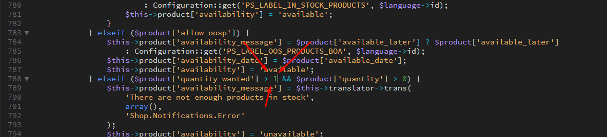

Diego Galma Posted August 25, 2020 Share Posted August 25, 2020 I think I fix doing this This } elseif ($product['quantity_wanted'] > 0 && $product['quantity'] > 0) { For this } elseif ($product['quantity_wanted'] > 1 && $product['quantity'] > 0) { Link to comment Share on other sites More sharing options...

Diego Galma Posted August 27, 2020 Share Posted August 27, 2020 I thought I had fixed it but it does not work, if anyone has any progress or correction please comment. Link to comment Share on other sites More sharing options...
