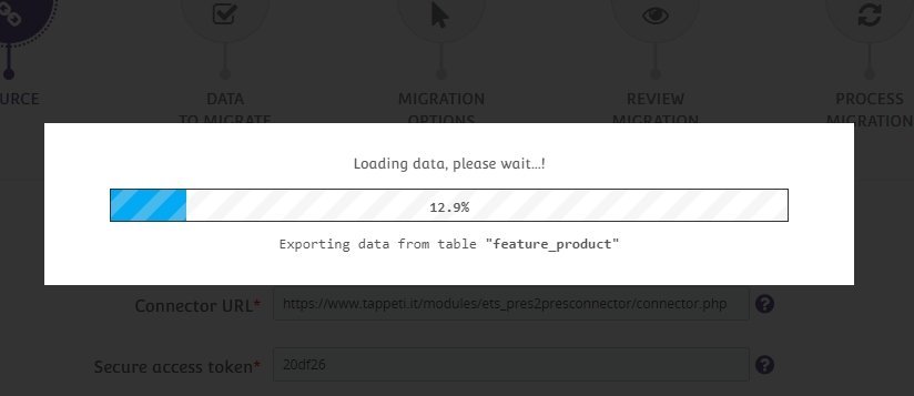

Hi,
in the past I used the free version to migrate a small site (150 products, 900 combinations), the process was completed successfully.
Now I started the migration of a site with 20K products (probably 100K combinations) and the percentage bar behaves in a funny way: it goes up and down! For example from 9% jumps up to 17% then up to 48% then down to 9% then up to 18% etc.
The text always says "Exporting data from table feature_product" (see image).
Is that correct?
Thanks for your support.
Navid

Hello,
Thank you so much for using our Prestashop Migrator free module.
May I ask which PrestaShop version installing on your destination website? Since the free module has not been updated for a while, it may not be compatible with the database structure of the latest PrestaShop version.
My best regard.
Edited by ets-soft (see edit history)
17 hours ago, Impatient said:
Hi,
the source site is PS 1.6.1.5 and the destination is 1.7.7.7
In the attachment a 4 minute screen recording showing the issue.
Thanks
Hello,
Since the structure of database tables in PrestaShop 1.7.7.x version is updated and different from the older versions, the data mapping process of our free module may be incorrect. And therefore, the data cannot be migrated.
We suggest you try "Migration 4.0" module to migrate a large amount of data in a short time, and it is compatible with the latest PrestaShop version. Or you may try "1-Click to Direct Upgrade" module to upgrade your source website to the latest PrestaShop version while still preserved all your data.
My best regard.
