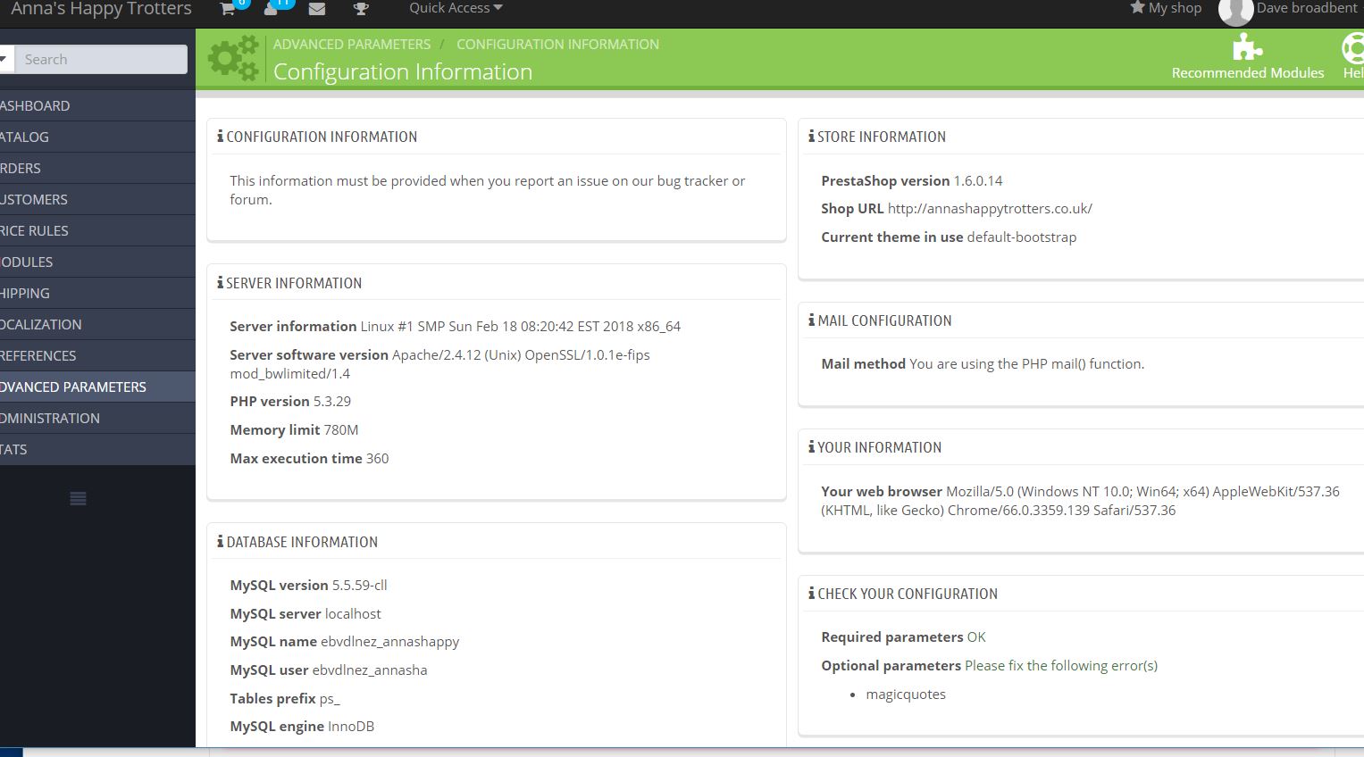

Plain Me Posted May 18, 2018 Author Share Posted May 18, 2018 HI How would I know - I'm not a coder, I use Prestashop because all the blurb states you don't need to know any code or indeed use it. It's Prestashop 1.6.0.14 that's all I know Link to comment Share on other sites More sharing options...
Rhobur Posted May 19, 2018 Share Posted May 19, 2018 Please do as Razaro said, go to Advanced Parameters > Configuration Information and do a screenshot, the required information is there. Link to comment Share on other sites More sharing options...
Plain Me Posted May 21, 2018 Author Share Posted May 21, 2018 OK - I've supplied login details to someone from support (16th May) still no response. The problem I had where my installation was corrupted I have resolved by restoring a backup previous to the date I tried to install this GDPR module that doesn't work. I still have the problem of a GDPR zip file sat on my desktop for which I paid £80 plus, which still does not work and unable to get the supposed free 3 months support from the developer (what a rip-off!!). I have lost all confidence in Prestashop, the support, the addons et al. Oh and I have included the screen shot you requested. I paid for the module through PayPal, so if I don't get this up and running before the 25th May then I will report the Prestashop team to PayPal for supplying something which does not meet up to its description and demand my money back. Link to comment Share on other sites More sharing options...
razaro Posted May 21, 2018 Share Posted May 21, 2018 You have bit old version of PHP on server 5.3.29. If you can not change that ask your hosting to change version of PHP to 5.5 or 5.6 and try GDPR module again. Link to comment Share on other sites More sharing options...
