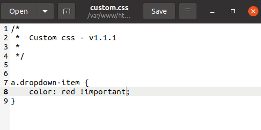

TristanBellosta Posted July 30, 2021 Share Posted July 30, 2021 Here's a css file overriding all rules implying the default blue and hover blue. You just have to change colors on lines 2-3 (in my example blue becomes some red) and copy / paste to your custom.css in theme folder. Hope it helps ! Based on PS 1.7.7..4 prestashop-change-color.css Link to comment Share on other sites More sharing options...

rthakur Posted November 24, 2022 Share Posted November 24, 2022 20 hours ago, NixxxoN said: Hello, I know it's a very old post but... I tried your solution and it works on 1.7.8.7, however, when I try to place a custom color instead of those reds, nothing changes.... Why?? And yes I tried clearing cache, no change still. Those things really drive me crazy. You can create a custom.css under themes/classic/assets/css/ After creating css clear cache then refresh your site Then you can write own custom css this is working fine i have already done this. Link to comment Share on other sites More sharing options...
