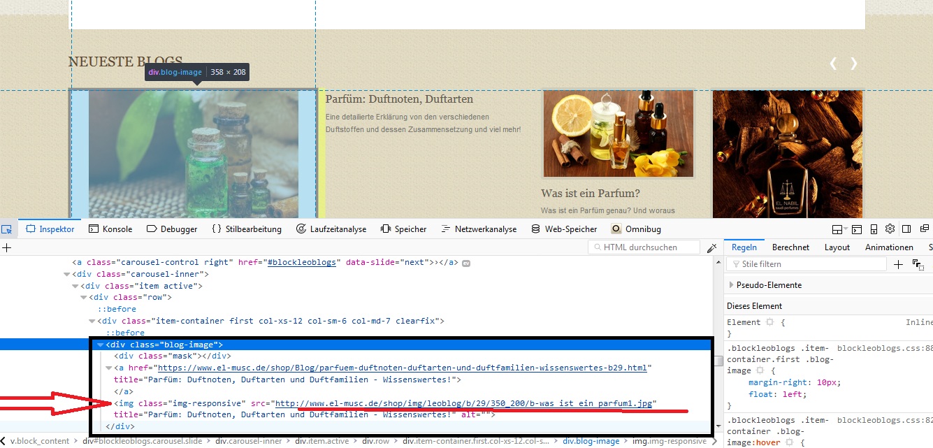

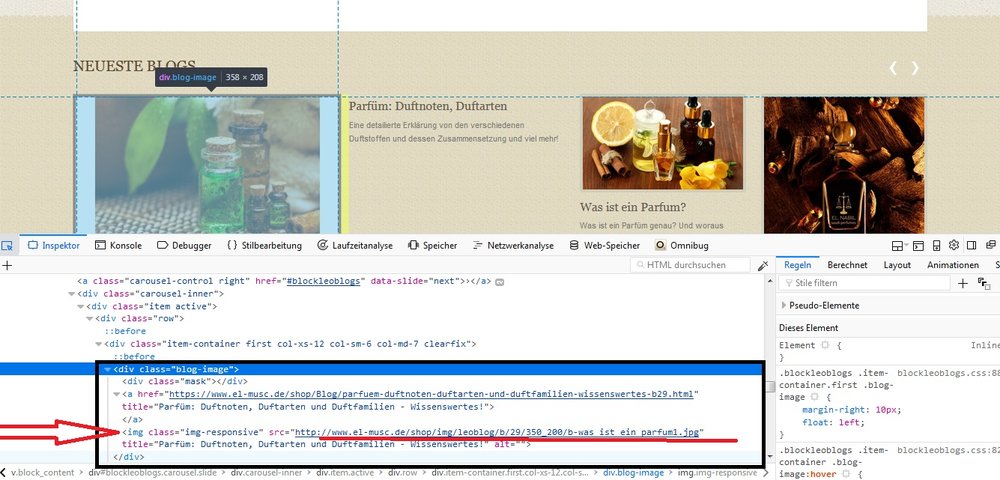

El-Musc.de Posted April 27, 2018 Share Posted April 27, 2018 (edited) Hello dear user, I have a small but stupid concern ..And although I have recently SSL installed on my webshop, it works synonymous as far as right, all the best, is also set correctly.However, on the start page, I have "Mixed Content" (my blog), which generates a SSL error.I also know where the problem lies:The pictures from the blog are not called via HTTPs, but unencrypted!How can I edit the links on the start page now? Eg where can I find the index.php / tpl to replace the links? Or how do you do that? Since I have 6 blogs, the error 6x also appears.Mixed Content: The page at 'https://www.el-musc.de/shop/' what loaded over HTTPS, but requested on insecure image 'http://www.el-musc.de/shop/img/leoblog /b/29/350_200/b-was%20ist%20ein%20parfum1.jpg '. This content should also be served over HTTPS. This is what the source code looks like: Unencrypted:<img class = "img-responsive" src = "http://www.el-musc.de/shop/img/leoblog/b/29/350_200/b-what is a parfum1.jpg" title = "Perfume: Fragrance Notes, Fragrance Types and Fragrance Families - Worth Knowing! " alt = ""> Where / how can I replace / update the links?Where can I find the index.php / tpl file from my homepage to adjust the codes, I just have to put an "s" in front of the links. Link to the shop: https://www.el-musc.de/shop - Just scroll down, then comes the blog with the pictures, so on the home page!If I remove the blog, then the whole page is in SSL and all errors disappear, so it's up to the unencrypted links, I would be very happy if I can help here, I'm already very desperate ... Such a small problem, but find the paths just not, for example, where is Index.php / tpl? Edited April 27, 2018 by El-Musc.de (see edit history) Link to comment Share on other sites More sharing options...
Kogkalidis Posted April 30, 2018 Share Posted April 30, 2018 It seems ok now sir, because you (or someone else) edited the corresponding module file and made the image links "relative" (that is to say it decides itself if its https or not). Please update the title adding [SOLVED] in the beginning and a descriptive explanation to the procedure you followed. Thank you in advance, Konstantinos Link to comment Share on other sites More sharing options...
