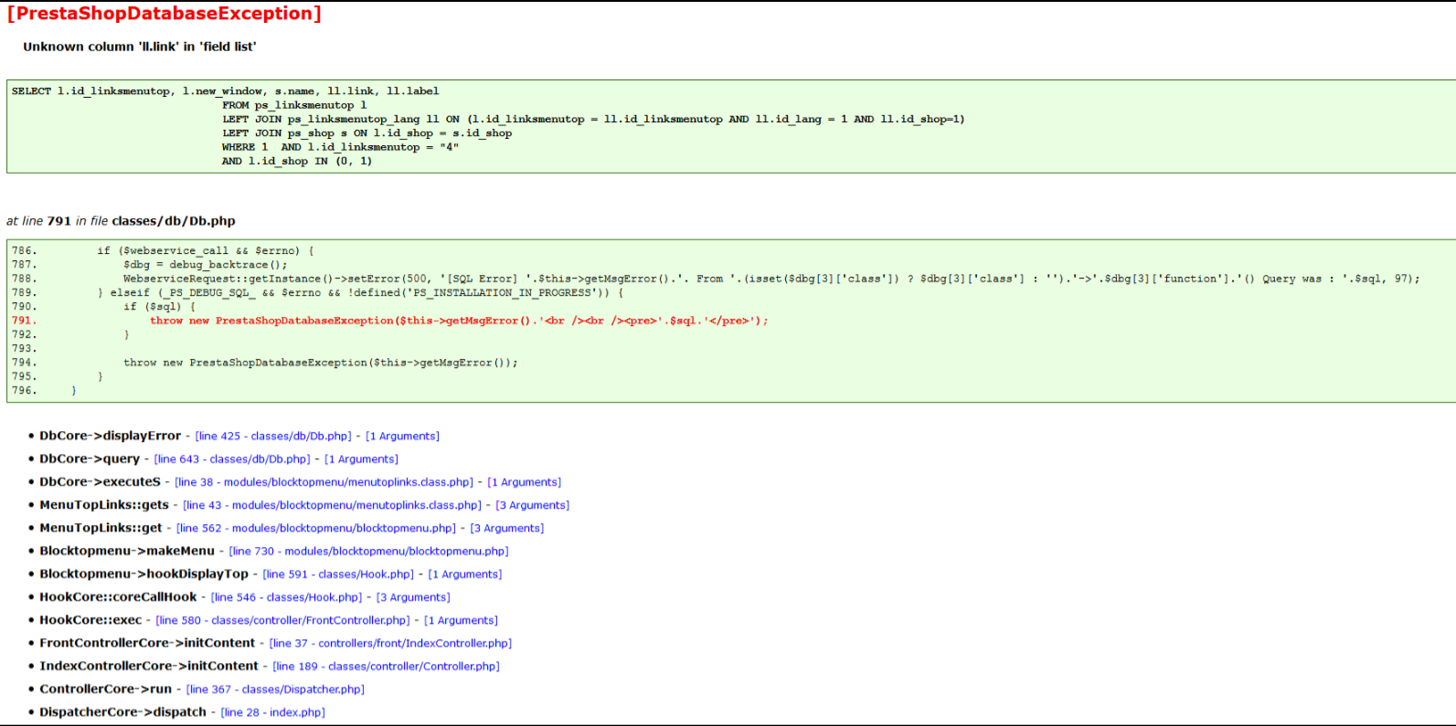

BlizzardUK Posted April 27, 2018 Author Share Posted April 27, 2018 (edited) Thanks for your continued help. So I have upgraded my clone site, and now I get this ? Any ideas ? See screenshot attached. (this is in debug mode, without it the site loads but is just a bit messed up looking) Edited April 27, 2018 by BlizzardUK (see edit history) Link to comment Share on other sites More sharing options...
selectshop.at Posted April 28, 2018 Share Posted April 28, 2018 The module blocktopmenu was adapted or it was part of your theme ? Tried to deinstall it from back-office and install it again ? Link to comment Share on other sites More sharing options...
