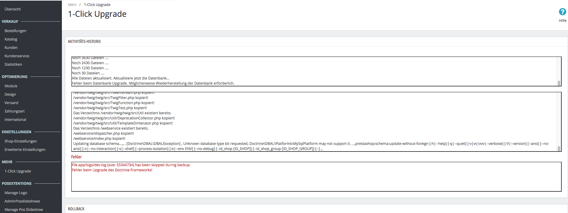

Peter_S83 Posted April 18, 2018 Share Posted April 18, 2018 Hi, I installed one week ago 1.7.3 and made a fresh shop. Now I wanted to update to 1.7.3.1 but getting always an error and only a rollback is possible. Updating database schema...,Executing: ALTER TABLE sps_bsf_supercheckout_analytics DROP FOREIGN KEY sps_bsf_supercheckout_analytics_ibfk_1,, , [Doctrine\DBAL\DBALException] , Unknown database type bit requested, Doctrine\DBAL\Platforms\MySqlPlatform may not support it. , ,,prestashop:schema:update-without-foreign [-h|--help] [-q|--quiet] [-v|vv|vvv|--verbose] [-V|--version] [--ansi] [--no-ansi] [-n|--no-interaction] [-s|--shell] [--process-isolation] [-e|--env ENV] [--no-debug] [--id_shop [ID_SHOP]] [--id_shop_group [ID_SHOP_GROUP]] [--] ,, and the message Error upgrading doctrine schema I know this one table is a module one page checkout, but I even deleted it and uninstalled the plugin, don't need it anymore. Nothing. I found a solution here with PS Cleaner, made it also, but still the same. A friend told me now, that the SQL squery BIT is only supported in MySQL 5.7 and I got 5.6. Do I need to update, will the error be than gone or any other help. Link to comment Share on other sites More sharing options...
Peter_S83 Posted April 19, 2018 Author Share Posted April 19, 2018 delted the plugin and restarted the php module and now I get only this message Updating database schema...,, , [Doctrine\DBAL\DBALException] , Unknown database type bit requested, Doctrine\DBAL\Platforms\MySqlPlatform may not support it. , ,,prestashop:schema:update-without-foreign [-h|--help] [-q|--quiet] [-v|vv|vvv|--verbose] [-V|--version] [--ansi] [--no-ansi] [-n|--no-interaction] [-s|--shell] [--process-isolation] [-e|--env ENV] [--no-debug] [--id_shop [ID_SHOP]] [--id_shop_group [ID_SHOP_GROUP]] [--] ,, so withouth the module. Something want to update but request a BIT????? and this is I think only possible in mysql 5.7 Link to comment Share on other sites More sharing options...

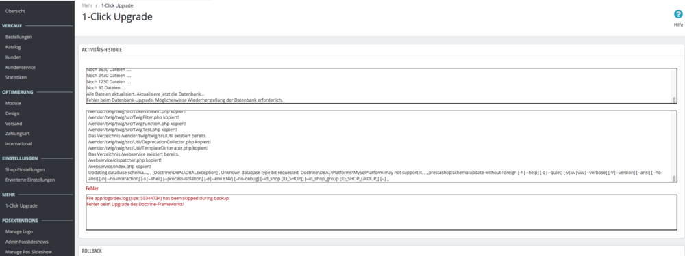

Peter_S83 Posted May 4, 2018 Author Share Posted May 4, 2018 still the same with 1.7.3.2, this pisses me really of. Installed a complete new version of Prestashop 1.7.3 on my system, added now 480 products and I can't update it. For now, ok, but what will be in one or two months when we got further versions which fix major problems and I can't install it. Looks like some other users have the problem too. Here is the screenshot of the newest update 1.7.3.2 which also doesn't work. Link to comment Share on other sites More sharing options...
bellini13 Posted May 7, 2018 Share Posted May 7, 2018 i reviewed both PS v1.7.3.0 and v1.7.3.1, and a few things 1) The database schema has not changed and are identical between the 2 versions 2) Prestashop does not use bit types You likely have installed a custom module, or perhaps added a custom table or column to an existing table using the bit column type. Which means this issue is specific to your store. You will need to go through your database tables and locate which table has a column with a bit type, and change it to perhaps an int instead. Alternatively if you need to use bit type, then you should try to perform a google search for the error message, and you might find solutions like the following... https://stackoverflow.com/questions/9744629/doctrine2-workaround-for-mapping-mysql-bit-data-type 1 Link to comment Share on other sites More sharing options...

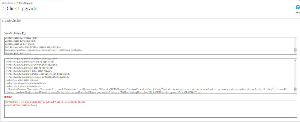

hitabnet Posted May 22, 2018 Share Posted May 22, 2018 Hello Bellini13, Thank you for your reply. This is the error that i am having. Do you know how i can fix this problem? I tried prestashop cleaner but nothing changed. Thank you for your time. ------------------------------------- , , [Doctrine\Common\Annotations\AnnotationException] , [Semantical Error] The annotation "@Doctrine\ORM\Mapping\I" in class PrestaShopBundle\Entity\StockMvt does not exist, or could not be auto-loaded. , ,,prestashop:schema:update-without-foreign [-h|--help] [-q|--quiet] [-v|vv|vvv|--verbose] [-V|--version] [--ansi] [--no-ansi] [-n|--no-interaction] [-s|--shell] [--process-isolation] [-e|--env ENV] [--no-debug] [--id_shop [iD_SHOP]] [--id_shop_group [iD_SHOP_GROUP]] [--] ,, (added for search engines) --------------------------------- Link to comment Share on other sites More sharing options...
