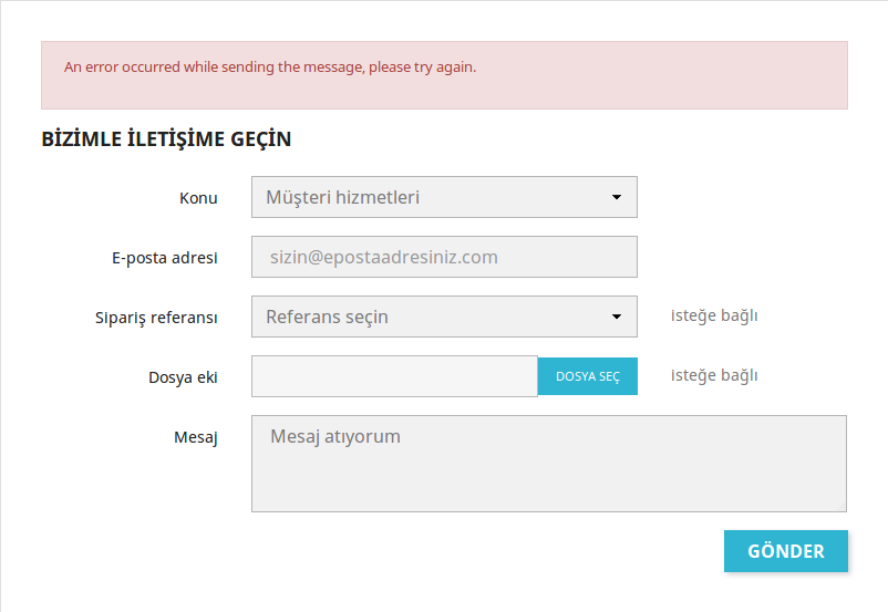

Can't submit a message from contact form.
Hi,
I am using prestashop 1.7 and its default theme.
I have a contact form but when I fill it and press send button it throws the error below in the image.
I don't really know what causes this error but I would like to ask you guys if any of you have encountered this error before and how to fix it?
Thanks!
Edited by Burak KAYMAKCI (see edit history)

Well, I had tried to upgrade my store to 1.7.3.1 but then somehow it failed. This might be the case here but ContactController.php is exactly the same as in 1.7.3.0. I might have to start comparing files then... :(
Well I have good news!
I have just figured out the problem.
Thanks to Dave L for reminding me that the problem could be because of the files, because that was the problem!
Actually, I'd tried to upgrade my shop to 1.7.3.1 when the notification first popped up. Then somehow the installation went wrong but the module I was using, which was 1-Click Upgrade, was saying something like "don't worry we will recover to the version that you were using before.". Well they didn't!
Then after Dave L's message I started thinking about which file or files could have possibly been changed. Using an online file compare tool I saw that contactform.php in /modules/contactform was different than the one I was using before.
After changing that file to the older one the problem was solved!
If that file was not the case for you I recommend you to try other files if you'd tried to upgrade the version to the newer one and failed during the process just like me.
Hope this helps people having the same issue without having to think about for days like me.
Cheers! :)
