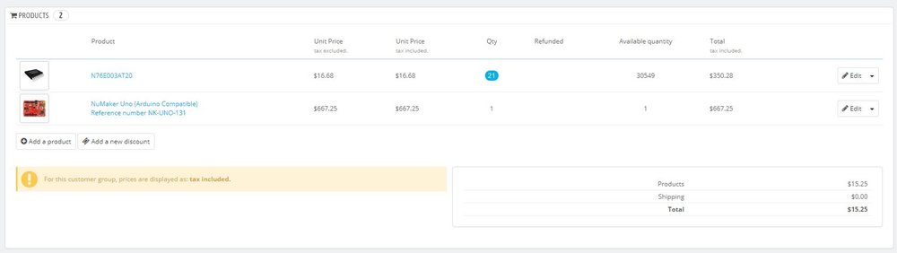

Hello, the order after March 27th is so wired.
The default currency of my eStore is USD. Though multiple currency options are offered, when the customer check-out at PayPal, it will display USD only.
These days, when customers check-out at JPY, INR, IDR, the unit price of orders would be wrong.
But when customer check-out in EUR, USD, the price will be correct.
The original price of N76E003 is $0.25, but it displays $16.68; the original price of NuMaker Uno is $10, but it displays $667.25.
Look down to the total price, it turns to the correct one, the sum up of $0.25x21 + $10 = $15.25.
Besides, the shipping fee rule is $6.99 for the order < $150, free shipping of the order $150 and up.
In this order, the total price is $15.25, it should be charged the shipping fee.
But the system seems to regard this order as free shipping, so I guess the shipping fee system see this order as the wrong total price ($16.68x21+$667.25=$1017.53)
Could anyone tell me that what is the problem?
