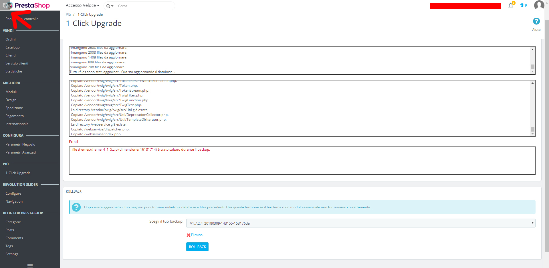

PrestaDesigner10 Posted March 9, 2018 Share Posted March 9, 2018 (edited) Hello, I'm trying to update my prestashop version (from 1.7.2.4 to 1.7.3) via 1-Click Upgrade Module. The process seems to stuck on database update. I'm waiting for an hour. What do you think the problem is? Thank you. Edited March 9, 2018 by PrestaDesigner10 (see edit history) Link to comment Share on other sites More sharing options...
