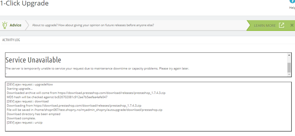

I am also getting the same error when trying to 1-click update from 1.7.4.2 to 1.7.4.3 .
[Ajax / Server Error for action unzip] textStatus: "error " errorThrown:"Service Unavailable " jqXHR: "
Service Unavailable
The server is temporarily unable to service your request due to maintenance downtime or capacity problems. Please try again later. "
I HAVE ALSO ATTACHED ERROR FILE PLEASE GUIDE ME TO FIX THIS ERROR. THANKS

/admin123/autoupgrade/ajax-upgradetab.php:1 Failed to load resource: the server responded with a status of 503 (Service Unavailable)
I found this
I found this
Not enough information. Such a debug is generally not possible without access to the server / site. In most cases, for example in yours.
As I said, you need a programmer to check everything.
Starting from the server settings, ending with PrestaShop itself, the database and modules.
