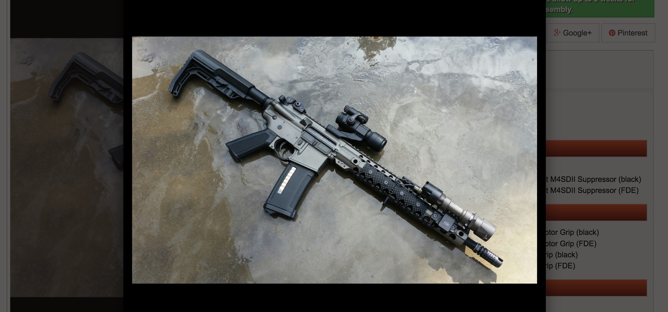

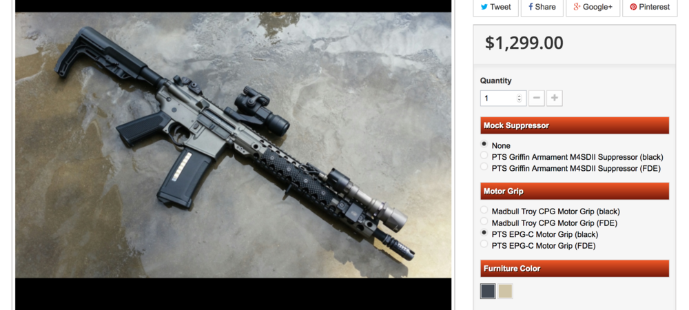

Tactical Parts Posted February 21, 2018 Author Share Posted February 21, 2018 This is what I see. First image is the product page. Second image is when you click the popup window: Link to comment Share on other sites More sharing options...
Tactical Parts Posted February 21, 2018 Author Share Posted February 21, 2018 Guess it doesn't translate the clarity difference very well when you attach screenshots Using a 2016 Macbook Pro which has a high definition retina screen if I recall correctly. Link to comment Share on other sites More sharing options...

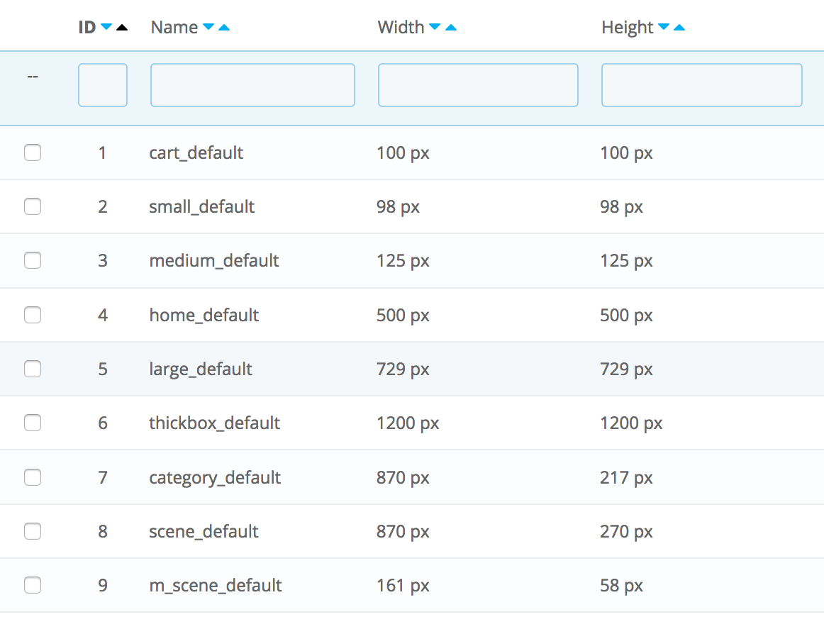

Tactical Parts Posted February 21, 2018 Author Share Posted February 21, 2018 I'm confused by this because my parameters in back office are defined as follows: Link to comment Share on other sites More sharing options...
Daresh Posted February 21, 2018 Share Posted February 21, 2018 everything is correct, for the large default there will be image 729x729, but you also have the high density option turned on, for that case you'll get 1458x1458 image 1 Link to comment Share on other sites More sharing options...
Tactical Parts Posted February 21, 2018 Author Share Posted February 21, 2018 Ah, that explains a lot! I didn't know that feature would override the defined options. So without changing my current images (which have all been generally resized to 1200x whatever to maintain proper ratio) , if I turned that button off would this fix the product page blurry image issue? Link to comment Share on other sites More sharing options...
