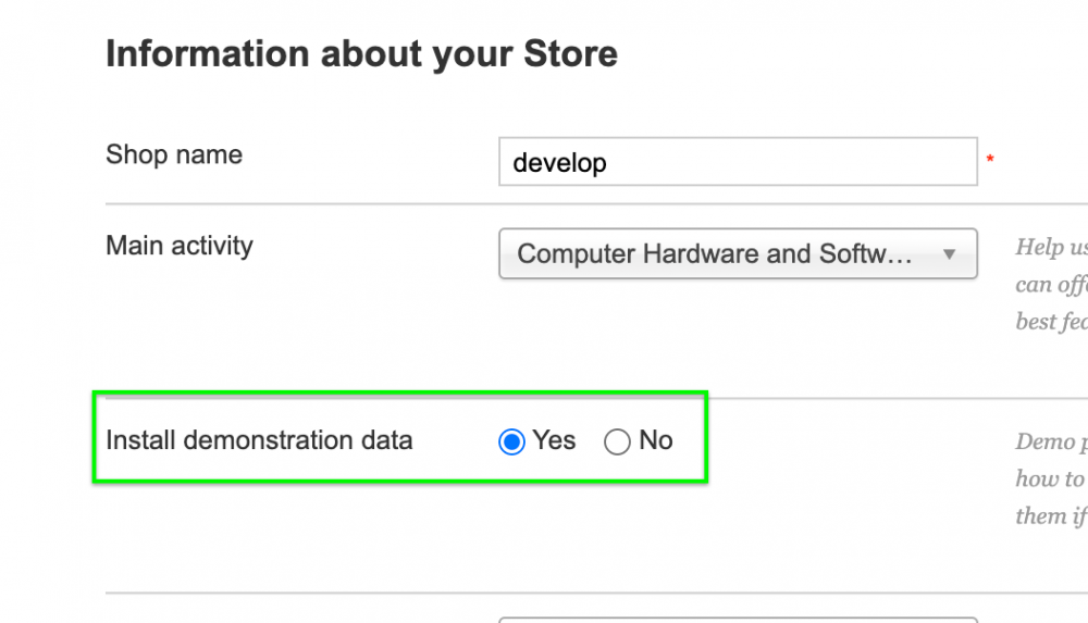

Tuni-Soft Posted December 6, 2021 Share Posted December 6, 2021 (edited) The easiest fix, is to enable demo data install This will be fixed in future versions hopefully (follow https://github.com/PrestaShop/PrestaShop/issues/26892) If you do not want to install demo data at all, you can edit this line File: install/controllers/http/process.php Line: } elseif (Tools::getValue('postInstall') && !empty($this->session->process_validated['installFixtures'])) { Change it to: } elseif (Tools::getValue('postInstall')) { Edited December 6, 2021 by Tuni-Soft (see edit history) Link to comment Share on other sites More sharing options...
