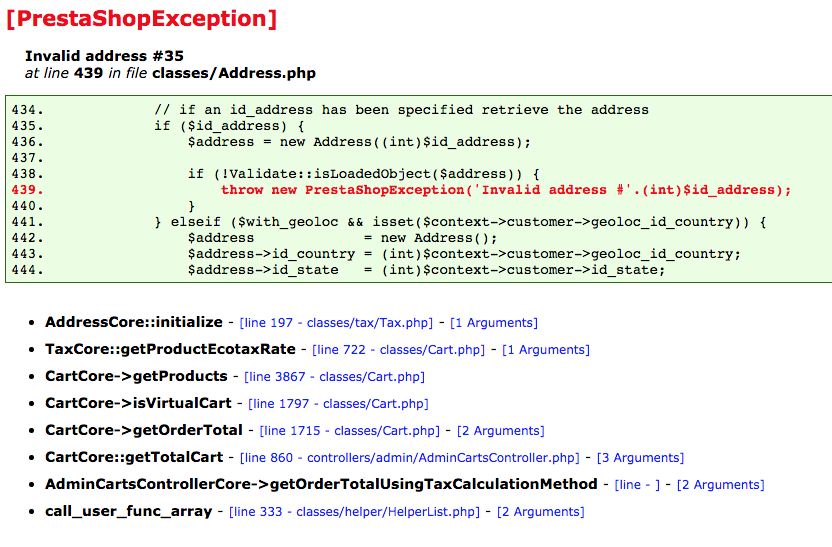

GlasInLood-Delden Posted February 12, 2018 Share Posted February 12, 2018 Hello, Prestashop was always working fine (version 1.7.2.4) Suddenly today I get the message as you can see in the picture I took. This appears when I try to add an order in Prestashops dashboard and when I log in as a customer. Could someone please help me solve this? Peter-Jan Rauch, the Netherlands Link to comment Share on other sites More sharing options...
musicmaster Posted February 12, 2018 Share Posted February 12, 2018 The error message says it all. There is a reference to an address with id 35 that is not present in the ps_address table. My guess on the base of your story would be that it is in the ps_cart table. You can either create an address with id 35 or change the references to that address in ps_cart. Link to comment Share on other sites More sharing options...
