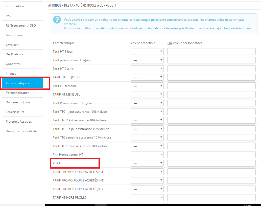

Jluis Posted February 12, 2018 Share Posted February 12, 2018 In order to update ps_feature_value , ps_feature_product database for existing products with valaues from a csv file as shown in the picture below , i made the function below , an error appears : CREATE PROCEDURE processorders() BEGIN DECLARE done INT DEFAULT FALSE DECLARE b , c , d int(10) DECLARE ordernumbers CURSOR FOR SELECT id_feature,id_product,id_feature_value FROM psdms_feature_product DECLARE CONTINUE HANDLER FOR NOT FOUND SET done = TRUE OPEN ordernumbers read_loop:LOOP FETCH ordernumbers INTO b,c,d IF done THEN LEAVE read_loop END IF IF (c) THEN IF (b == 510) THEN update psdms_feature_value_lang t1 LEFT JOIN psdms_feature_product t2 ON t1.id_feature_value = t2.id_feature_value SET value ='95090€' WHERE t2.id_product = 1 AND t2.id_feature = 510 ELSE insert into psdms_feature_value ( id_feature ) values (510) insert into psdms_feature_product ( id_feature, id_product , id_feature_value) values (b , c , d ) END IF END IF END LOOP CLOSE ordernumber END the error is : Quote Erreur dans la requête (1064): Syntax error near 'DECLARE b int(10) DECLARE c int(10) DECLARE d int(10) DECLARE orde' at line 7 Any suggestion please ?? Link to comment Share on other sites More sharing options...

Jluis Posted February 12, 2018 Author Share Posted February 12, 2018 i'm the owner , i would like to modify " caractéristique->prix HT " as mentionned in the image . If the product has that old value just we update it , if not we create a new feature and associate to the situable product as mentionned in code , this does not work? Link to comment Share on other sites More sharing options...

Jluis Posted February 12, 2018 Author Share Posted February 12, 2018 sorry , but ps_product and ps_product_shop tables doesn't contain any Column as shown in image ( the boxed area in red ) characteristics section , price HT attribute Link to comment Share on other sites More sharing options...
