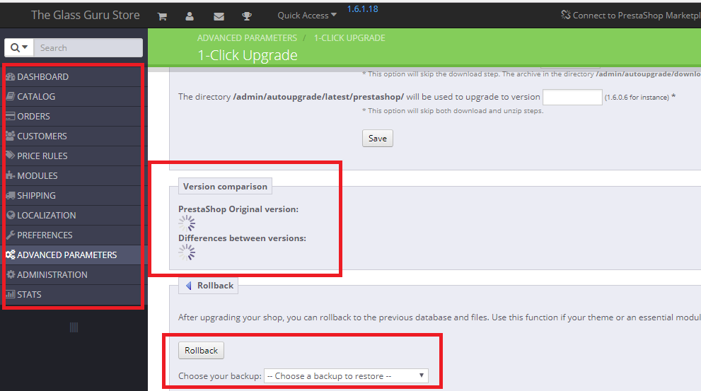

Upgrade Failed - Rollback Not Working - What Can I Do?
Combination imports did not work for us and the Forum said an upgrade should resolve. The upgrade failed with the following message and now the Admin site is not fully functional and we cannot rollback.
What can we do??
EDIT: The 1-Click Upgrade was used for this and installed the latest MAJOR version with no other choice. It should install the most recent STABLE version,
1.6.1.18

[Ajax / Server Error for action upgradeDb] textStatus: "error " errorThrown:"Internal Server Error " jqXHR: "
The server encountered an internal error or misconfiguration and was unable to complete your request.
Please contact the server administrator to inform of the time the error occurred and of anything you might have done that may have caused the error.
More information about this error may be available in the server error log.

Unfortunately there is not much you can do AFTER the fact.  Its a hard lesson to learn, but you really should do some research into you to properly upgrade and test first.  The upgrade documentation on the Prestashop website would have warned you to ensure you have fully backed up your store before the upgrade.
And I cannot stress this enough... Never rely on the backup options of the upgrade module... I think you now know why...
The administrator was able to rebuild certain modules that were damaged. The big issues I found are:
1. Prestashop does not work well AT ALL with Chrome and Firefox should be used.
2. The CSV import is still terrible ... we could barely import 20 Combinations at a time. It took 65 upload files to complete our data.
Thanks for the help!!

I get the exact same error when trying to 1-click update from 1.6.1.17 to 1.6.1.18 ?? Had to fallback to a manual back as the rollback function does not work either - this is pretty bad !  No changes on the server and 1-click upgrades has worked so far - so what is going on here ??
