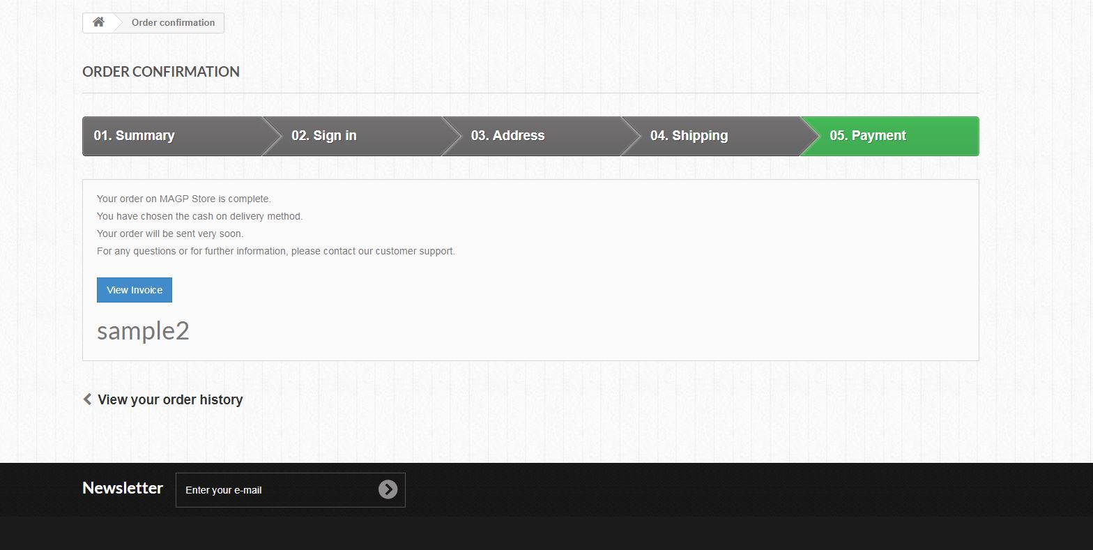

Homer Aldea Posted February 11, 2018 Share Posted February 11, 2018 How do I add an invoice button that will view the invoice in the payment tab after the customer finished ordering? Link to comment Share on other sites More sharing options...

Homer Aldea Posted February 11, 2018 Author Share Posted February 11, 2018 Thanks for the reply. I meant after ordering the products. A button where you can view the invoice of your last order Link to comment Share on other sites More sharing options...

Homer Aldea Posted February 12, 2018 Share Posted February 12, 2018 Thanks. But the link you gave is not applicable for this. I just want to add a "View Invoice" button that let the customer view his/her invoice in the next tab of the browser in step 5 after they confirmed their order. My mode of payment is only Cash On Delivery. Please see the above screenshot. I already added a button "View Invoice" and I just want to happen is if you click the button, the customer can view his/her invoice in the next tab. Thanks. Greatly Appreciated. Link to comment Share on other sites More sharing options...
jgamio Posted February 13, 2018 Share Posted February 13, 2018 Is the same but let me explain You need a secure code inside the link to be able to print the invoice, if you dont have that everybody can print the invoices You can't do it without changing the payment module Link to comment Share on other sites More sharing options...
