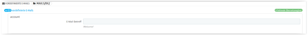

Dear community,
We detected an odd behavior on Prestashop 1.7.2.4 that maybe somebody knows already. Pls let us know.
Issues as following:
- We cannot see the subject translations, although we translated it. Fields remain empty (pls see illustration below) for 3rd party and Prestashop modules.
- We use a child_theme: Therefore some of the translations are stored by Prestashop to /themes/classic_childtheme/mails/de/lang.php (3rd party module reading form here), /mails/de/lang.php (Prestashop seems not to use this anymore for own and 3rd party mail translation) and /app/Resources/translations/de-DE/EmailsSubject.de-DE.xlf. 3rd party modules cannot saved to EmailsSubject.de-DE.xlf indeed. If we send the mail, the data is working but we cannot amend it via BO or if we do, we delete the current translations.
- Also Umlaute seem not to work properly if used in old translation way through .txt file. Email is not being sent in this case. Without Umlaute it works fine.
Solution:
We have found a workaround for us but we believe that it could be a Prestashop 1.7.2.4 issue. Our workaround includes a programming change (override) of AdminTranslationsController.php to actually use the lang.php file (seems missing). To us, new translation file EmailsSubject.de-DE.xlf seems not to work for Prestashop modules and 3rd party modules either. It's just not in the code. We now changed to use lang file from /mails/yourLang/lang.php only and this works as a workaround to change the subject in the mail translation as well as to send the mail subject title in correct language.
Edited by Kunsthelden (see edit history)

                        $mail_name = substr($mail_name, $module_name_pipe_pos + 1);
                        if (!Validate::isTplName($mail_name)) {
                            throw new PrestaShopException($this->trans('Invalid mail name "%mail%"', array('%mail%' => Tools::safeOutput($mail_name)), 'Admin.International.Notification'));
                    if ($type_content == 'html') {
                        $content = Tools::htmlentitiesUTF8($content);
                        $content = htmlspecialchars_decode($content);
                        // replace correct end of line
                        $content = str_replace("\r\n", PHP_EOL, $content);
                        // Magic Quotes shall... not.. PASS!
                        if (_PS_MAGIC_QUOTES_GPC_) {
                            $content = stripslashes($content);
                    if (Validate::isCleanHTML($content)) {
                        $path = $arr_mail_path[$group_name];
                        if ($module_name) {
                            $path = str_replace('{module}', $module_name, $path);
                        if (!file_exists($path) && !mkdir($path, 0777, true)) {
                            throw new PrestaShopException($this->trans('Directory "%folder%" cannot be created', array('%folder%' => dirname($path)), 'Admin.International.Notification'));
                        if ($type_content == 'tpl') {
                            preg_match('/{\s*[^$]+/s', $content, $matches);
                            if (!empty($matches)) {
                                throw new PrestaShopException($this->trans('Your email translations contain some invalid HTML and cannot be saved. Please check your content.', array(), 'Admin.International.Notification'));
                        file_put_contents($path.$mail_name.'.'.$type_content, $content);
                    } else {
                        throw new PrestaShopException($this->trans('Your HTML email templates cannot contain JavaScript code.', array(), 'Admin.International.Notification'));
        // Update subjects
        $array_subjects = array();
        if (($subjects = Tools::getValue('subject')) && is_array($subjects)) {
            $array_subjects['core_and_modules'] = array('translations' => array(), 'path' => $arr_mail_path['core_mail'].'lang.php');
            foreach ($subjects as $subject_translation) {
                $array_subjects['core_and_modules']['translations'] = array_merge($array_subjects['core_and_modules']['translations'], $subject_translation);
        if (!empty($array_subjects)) {
            foreach ($array_subjects as $infos) {
                $this->writeSubjectTranslationFile($infos['translations'], $infos['path']);
                $this->writeSubjectTranslationFile($infos['translations'], _PS_THEME_DIR_.'mails/'.$this->lang_selected->iso_code.'/lang.php'); // Added  17.09.2018
        if (Tools::isSubmit('submitTranslationsMailsAndStay')) {
            $this->redirect(true);
        } else {
            $this->redirect();
     * Get list of subjects of mails
     * Added
     * @param Language    $subject_mail
     * @param string      $moduel_name
     * @return array with translations
    protected function getSubjectMailTrans($subject_mail, $module_name)
            $dirMail = 'mails/'.$this->lang_selected->iso_code.'/';
            $file = 'lang.php';
            // If is file
            if (is_file(_PS_THEME_DIR_.$dirMail.$file) && preg_match('/lang.php/', $file)) {
                $lines = file(_PS_THEME_DIR_.$dirMail.$file, FILE_IGNORE_NEW_LINES | FILE_SKIP_EMPTY_LINES);
                foreach ($lines as $line_num => $line) {
                $line_array = explode("'", $line);
                      if ($subject_mail == $line_array[1]) {
                   	        $subject_mail_trans = $line_array[3];
            else {
                if (is_file(_PS_ROOT_DIR_.'/'.$dirMail.$file) && preg_match('/lang.php/', $file)) {
                     $lines = file(_PS_ROOT_DIR_.'/'.$dirMail.$file, FILE_IGNORE_NEW_LINES | FILE_SKIP_EMPTY_LINES);
            return $subject_mail_trans;
This is a work-around only. We just copy the data to further areas in Prestashop (default, classic, child_themes). So we have the translation variable anywhere. As you can see this is an override.
Kind regards
