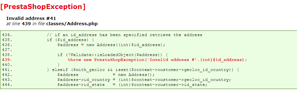

carlos12313 Posted December 26, 2017 Share Posted December 26, 2017 I don't know i can't see anything on Active shopping or Any shopping cart even abondon. Please help tell me what should i do or need to replace , Thank you all for your help. Link to comment Share on other sites More sharing options...
musicmaster Posted December 26, 2017 Share Posted December 26, 2017 The best approach is probably to go to the database and look into the ps_address table for the entry with id number 41. Check whether it is present and check whether it has valid texts (just compare it with other addresses). Link to comment Share on other sites More sharing options...
carlos12313 Posted December 26, 2017 Author Share Posted December 26, 2017 Thank you, I don't have ps_address , i have p***_address on my data base. I was viewing address part of the office don't have ID# 41. Anything else may come in mind looking at the error everything help. Link to comment Share on other sites More sharing options...
musicmaster Posted December 26, 2017 Share Posted December 26, 2017 It is custom on this forum to refer to table as if you had defined the prefix as ps_. So congratulations that you have a different prefix but that shouldn't be relevant for solving your problem. Obviously somewhere there is a reference to that refers to address 41. If it hasn't been defined you can do two things. You can either create one by duplicating another entry in the ps_address table and giving it id 41. Or you can find out what refers to it and make a change there. The most likely referring tables are ps_orders, ps_customer and ps_guest. Link to comment Share on other sites More sharing options...
carlos12313 Posted December 26, 2017 Author Share Posted December 26, 2017 Thank you so much , i have fix problem all about the _address (41) created on from double fix the problem. Yeah, it was exciting thank you. 1 Link to comment Share on other sites More sharing options...

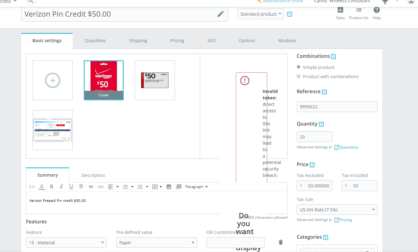

carlos12313 Posted December 26, 2017 Author Share Posted December 26, 2017 Do you know how i can fix this small problem Everytime i click on my product get error now.. Link to comment Share on other sites More sharing options...

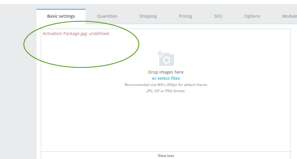

carlos12313 Posted December 27, 2017 Author Share Posted December 27, 2017 can not upload images to any of the product see picture for error. Link to comment Share on other sites More sharing options...
