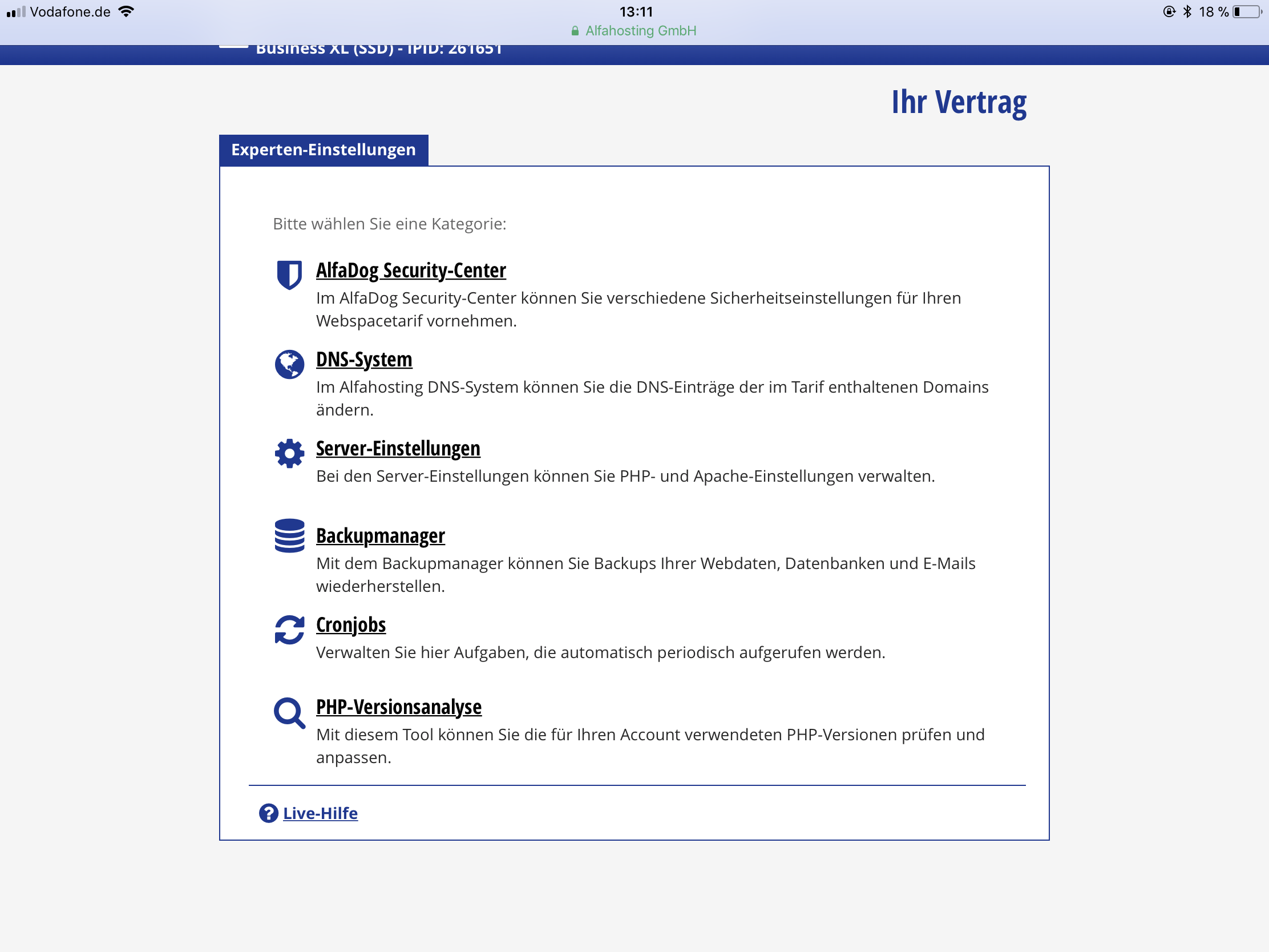

dumbledore Posted December 21, 2017 Author Share Posted December 21, 2017 Eventuell hier irgendwo? Link to comment Share on other sites More sharing options...
Claudiocool Posted December 22, 2017 Share Posted December 22, 2017 eventuell die Servereinstellungen, aber ohne Gewähr.... Link to comment Share on other sites More sharing options...
