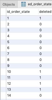

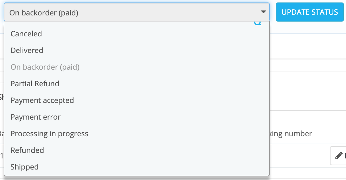

littlegreenguy Posted January 24, 2019 Share Posted January 24, 2019 ps version: 1.7 (maybe other versions too) I've found a way that I've not fully tested but which I presume is pretty harmless! If you have database access, on the: ed_order_state table, there is a 'deleted' column - kinda like a 'soft delete' - you can cross reference the id_order_state with the: ed_order_state_lang table to see the label of the order status and then enter '1' in the relevant record's 'deleted' column. It can be easily undone by changing back to a zero. Link to comment Share on other sites More sharing options...
