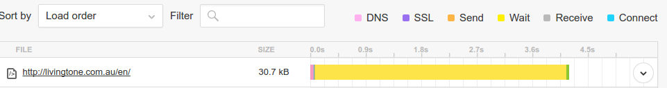

JWDT Posted November 11, 2017 Share Posted November 11, 2017 Hey Kevin, I've taken a look at the site, and ran it through the Pingdom speed test. Some of the images could be smaller, but that's not going to speed up the site. Not noticeably. That's was the second thing I spotted when I checked it. The first was that it's just on a slow server. No matter what you do to improve the site, it's not going to get any faster. The yellow section "Wait", is how long the server took to figure out what should go on the homepage. The tiny green section at the end is how long it took to send the main HTML of the site. All the CSS and JS was measured in tens or hundreds of milliseconds. Even the big images were. The Wait time was over 3 full seconds. The solution is basically to move to a new server. Even a low-mid range (2-3 CPU cores + 2-3GB RAM) VPS would outperform what it's on right now and would allow you to fine tune it a lot more than the current hosts. Your site is beautiful, by the way! Link to comment Share on other sites More sharing options...
