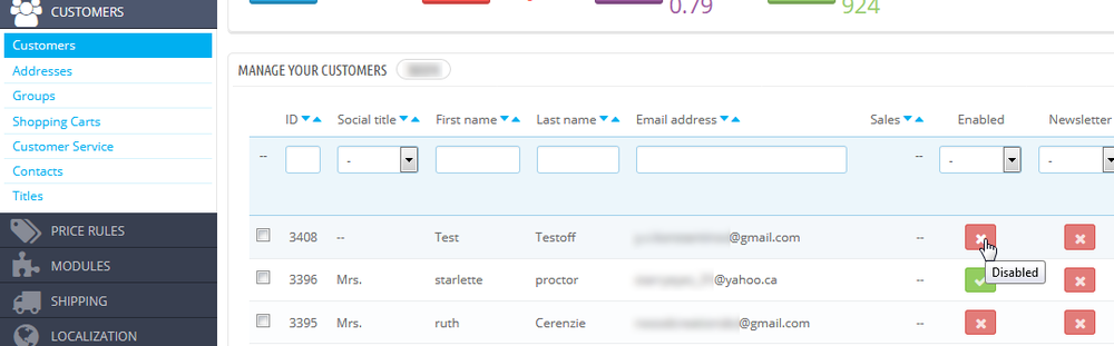

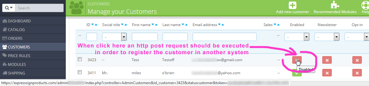

Yuriy Posted November 7, 2017 Share Posted November 7, 2017 Hi, what function enables a Customer? It seems not AdminCustomersController.php processGuestToCustomer(), nor AdminCustomerPreferencesControllerCore updateOptionPsB2bEnable($value), checked overriden also. Used logging. PrestaShop™ 1.6.0.14 We need to add a php code at the point of enabling Customer. So, when a Customer becomes enabled, an http post request should go somewhere. In general, how to find a needed function? I'm new to php. Restart of server is undesired. Link to comment Share on other sites More sharing options...

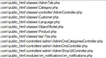

Yuriy Posted November 8, 2017 Author Share Posted November 8, 2017 4 hours ago, cristic said: The function responsible for enabling/disabling a model (in this case Customer class) is AdminController::processStatus(). Mmm... cristic, I can't detect the call of function classes\controller\AdminController::processStatus(). Tried to put inside the function: error_log, debug_backtrace, echo '<script>alert("Controller run()");</script>'; and print_r Exception trace - the ways I know, and nothing of this showed. Meanwhile, function of the same file AdminController::__construct() was called, ran. And CustomerCore::__construct() also seen. Maybe processStatus() was overriden? But no, here are all the files that contain text "processStatus()": AdminCategoriesController was not called. Also I tried another methods to find the function, but nothing. Miracles. Link to comment Share on other sites More sharing options...

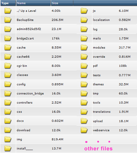

Yuriy Posted November 8, 2017 Author Share Posted November 8, 2017 1 hour ago, bellini13 said: creating an override of the Customer class, and extending the toggleStatus function Thank God for your reply, bellini13 Alright, I tried. public_html//override/classes/Customer.php already existed, just added: public function toggleStatus() { parent::toggleStatus(); ini_set("log_errors", 1); ini_set("error_log", "log.log"); error_log("Customer toggleStatus()"); } And that's strange: no "toggleStatus" in log. At the same time AdminController::__construct() and CustomerCore::__construct() appear in log. Of course I tried to log outside parent public_html//classes/Customer.php - just for test - and no result also. That's the problem: the functions that should be called seem to be not. But system is working well since 2015. And customers become enabled/disabled. Why the functions don't print in log? and debug_backtrace, js popup, print_r Exception don't act too. Not understood where the functions that do logic dwell then. Directories in public_html: Link to comment Share on other sites More sharing options...

Yuriy Posted November 15, 2017 Author Share Posted November 15, 2017 (edited) Good news. I found the place in code: override/controllers/admin/AdminCustomersController.php::processChangeStatusVal(). It was obvious from the begining, still don't know why it didn't show any logging and debug popups, or echos. But it sends http POST fine. Thank God for all the generous help by people here. So the main caveat was impossibility of detecting the function run because logging/debug popups/echos didn't show up. SOLVED Edited November 15, 2017 by Yuriy (see edit history) Link to comment Share on other sites More sharing options...
