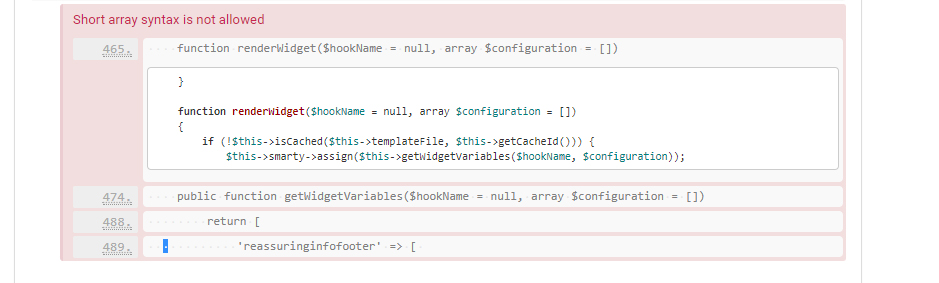

Nocebo Posted October 21, 2017 Share Posted October 21, 2017 Hello, I'm trying to pass my module to the validator, but I have this error: I do not know how to fix it. thank you in advance Link to comment Share on other sites More sharing options...
razaro Posted October 21, 2017 Share Posted October 21, 2017 Short array syntax is this [] , you should use array() . And do not think that modules that comes with PrestaShop would pass validator, even that they use short syntax Link to comment Share on other sites More sharing options...
Nocebo Posted October 21, 2017 Author Share Posted October 21, 2017 Thank you for your help. I know that the original modules do not pass the validator, but I use it as a starting point Link to comment Share on other sites More sharing options...
Nocebo Posted October 22, 2017 Author Share Posted October 22, 2017 When I do this the module does not install anymore ['media' => 'all', 'priority' => 150] ('media' => 'all', 'priority' => 150) Link to comment Share on other sites More sharing options...
razaro Posted October 22, 2017 Share Posted October 22, 2017 well this ['media' => 'all', 'priority' => 150] should be array('media' => 'all', 'priority' => 150) so [] equal to array(), not () Link to comment Share on other sites More sharing options...
