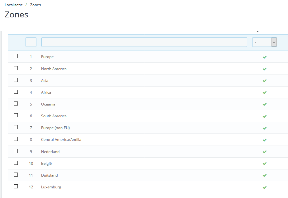

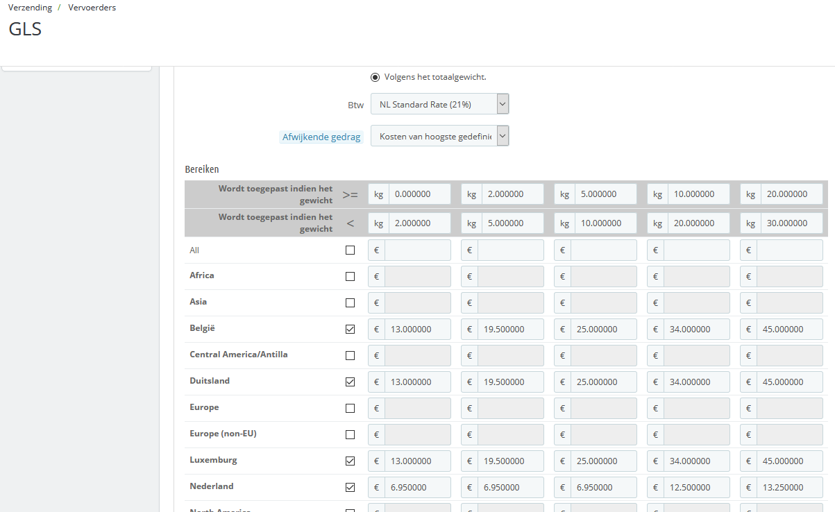

RemySan Posted October 2, 2017 Author Share Posted October 2, 2017 Are carriers set up within the products or are all products eligible to use all carriers? How many and which carriers have you set up? For which zones are these carriers enabled? Did you check the zone settings under locatlization to make sure the zone belongs to the correct country? Are carriers set up within the products or are all products eligible to use all carriers? All products are eligible to use all carriers. How many and which carriers have you set up? I have 3 carriers, PostNL, GLS and pickup. These carriers are self created. Here a screen from one of the carriers how it's set up. Carrier Setup: For which zones are these carriers enabled? These zones are enabled: België, Germany, Netherland and Luxemburg. All of these zones are enabled. Look at the screen. Zones: Did you check the zone settings under locatlization to make sure the zone belongs to the correct country? Yes these settings are correct. The weird thing of this situation is that it has worked. He stopped at once. Link to comment Share on other sites More sharing options...
Scully Posted October 2, 2017 Share Posted October 2, 2017 (edited) Settings look good so far. My strong opinion is the following: While installing and uninstalling modules with some troubles, something has interfered with your carrier settings or your backup was not a full backup and the carrier settings activated with the backup do not match other database settings. Edited October 2, 2017 by Scully (see edit history) Link to comment Share on other sites More sharing options...
