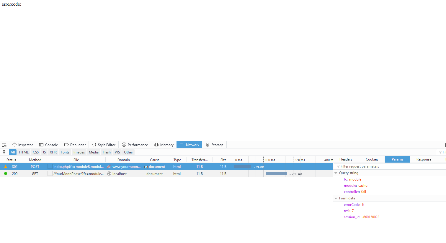

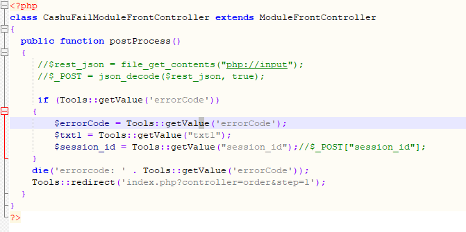

_theLion Posted September 20, 2017 Share Posted September 20, 2017 (edited) I am new to Prestashop and I am trying to build a payment gateway module.It all works fine until I try and get the parameters for the return URL. For some reason the post parameters always comeback as blank or none as existent. I have tried checking on the browser debugger to see if it was actually sending something and all the required data is there. Here is the code: Here is the output: This is the return URL:..."index.php?fc=module&module=cashu&controller=fail" PS: I am running on a Local Host. Edited September 20, 2017 by _theLion (see edit history) Link to comment Share on other sites More sharing options...
catalin.pop Posted September 20, 2017 Share Posted September 20, 2017 Try using php filter_input and see if it's working instead of Tools::getValue $errorCode = filter_input(INPUT_POST, 'errorCode'); based on Tools:getValue method from their source code: public static function getValue($key, $default_value = false) { if (!isset($key) || empty($key) || !is_string($key)) { return false; } if (getenv('kernel.environment') === 'test' && self::$request instanceof Request) { $value = self::$request->request->get($key, self::$request->query->get($key, $default_value)); } else { $value = (isset($_POST[$key]) ? $_POST[$key] : (isset($_GET[$key]) ? $_GET[$key] : $default_value)); } if (is_string($value)) { return stripslashes(urldecode(preg_replace('/((\%5C0+)|(\%00+))/i', '', urlencode($value)))); } return $value; } try to debug your module and see where what is not reading the parameter.. maybe has something to do with $_POST[$key] Link to comment Share on other sites More sharing options...
_theLion Posted October 10, 2017 Author Share Posted October 10, 2017 I've figured out that it was just the way that I had set up the server. Everything was being redirected so I just stopped it from doing that. I'm getting all the parameters now. Link to comment Share on other sites More sharing options...
