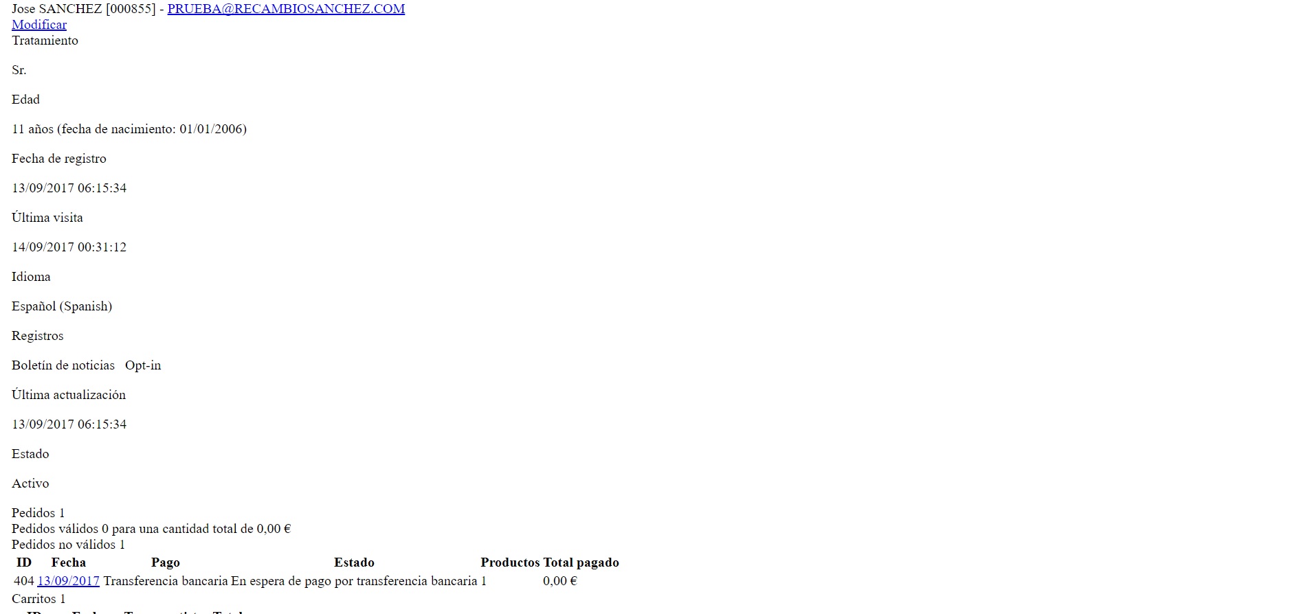

jmsg86 Posted September 13, 2017 Share Posted September 13, 2017 Hello everybody, firstly i want to thanks you for all your aportation in this forum wich was very useful for me. I upgrade from 1.4.9 to 1.6.1.17 with 1 click update, after that i get many problems already solved but there is one that i have no idea how look for the solution. When im on back office, i click in customers, i can see all of them but once i click in any an html web out of backoffice open. to better understand i add an image. Link to comment Share on other sites More sharing options...
bellini13 Posted September 14, 2017 Share Posted September 14, 2017 If I had to guess, you have a module or customization/override installed from your prior version (1.4.9) that is not compatible with PS v1.6. You will need to go through the list of modules, and see if that is a true statement. You should also try to enable debug mode in Prestashop, to see if an error message will appear Link to comment Share on other sites More sharing options...
jmsg86 Posted September 14, 2017 Author Share Posted September 14, 2017 If I had to guess, you have a module or customization/override installed from your prior version (1.4.9) that is not compatible with PS v1.6. You will need to go through the list of modules, and see if that is a true statement. You should also try to enable debug mode in Prestashop, to see if an error message will appear Thanks! wishlist module was the problem, i uninstalled it and now it shows perfect. Now i have a new issue... at product page (front office) when you change an attribute the web refresh and you only can select the refered attribute. In every products, even i tried to create new product, new attributes and same problem appears. You can check here: https://goo.gl/Zi2YNC try to change "Talla" and you will see Thanks again Link to comment Share on other sites More sharing options...
