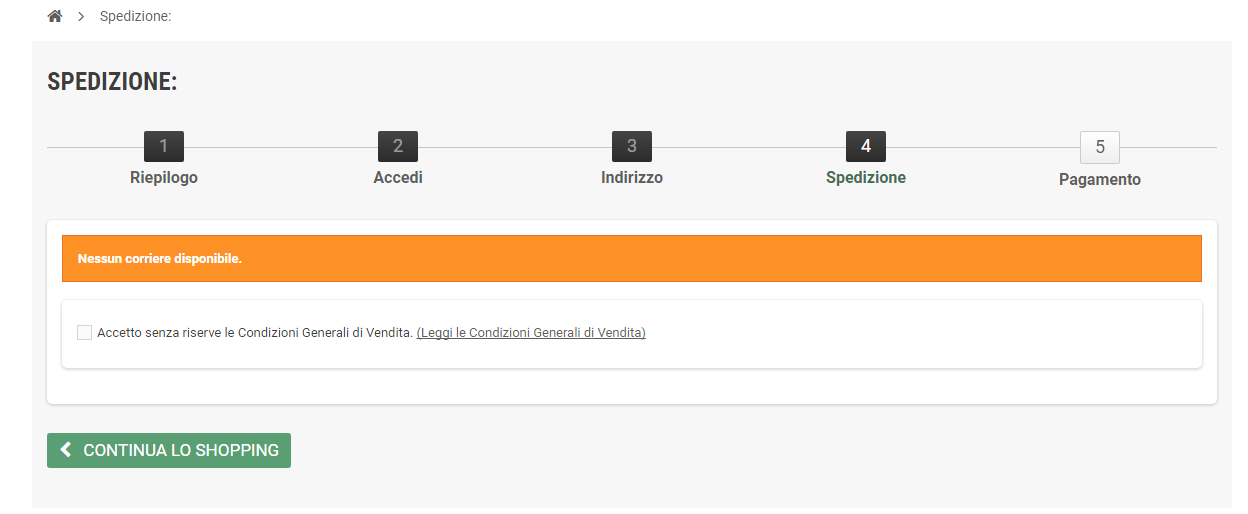

polidea Posted September 11, 2017 Share Posted September 11, 2017 Hello everyone,I have this huge problem, i'm talking about the back office side, i have set in the shipment tab two kind of couriers,i've modified the default couriers that prestashop gives you, one free shipment which it is fine, it works perfectly, and the other one it's a no free shipment courier service.I've made my e-commerce website and i'm testing it emulating a payment step by step by the kart, and the problem show up at the checkout time, when i need to choose the courier service method, but Prestashop it shows me always the free shipment and not both.I've tried every kind of solution failing all the time, i hope you guys can help me to resolve it, thanks in advance. I'm attaching a screenshot which now it worse , ti doesn't show up even the free delivering.you can notice that in the shipping tab, there are no couriers available even the free one Link to comment Share on other sites More sharing options...
mysho Posted September 11, 2017 Share Posted September 11, 2017 (edited) A few basics which might be your problem caused by: -don't you have "turn off" in the "out of range option"? (countries and costs tab in the carrier's settings) -do you have any active carrier for acountry selected during the checkout? Edited September 11, 2017 by mysho (see edit history) Link to comment Share on other sites More sharing options...
polidea Posted September 12, 2017 Author Share Posted September 12, 2017 A few basics which might be your problem caused by: -don't you have "turn off" in the "out of range option"? (countries and costs tab in the carrier's settings) -do you have any active carrier for acountry selected during the checkout? Thanks for your answer, unfortunately i've tried both options, i'm talking about your first point, i used turned off and on and both still don't work , about your second point i don't know how handle it. Is there any chance that i removed all nations that i don't want and i just kept Italy , and for some reason the deliver system it's messed up?? Link to comment Share on other sites More sharing options...
Scully Posted September 12, 2017 Share Posted September 12, 2017 Possible. You need to check your zones settings within localization. And your carriers must be assigned to at least one zone. Link to comment Share on other sites More sharing options...
