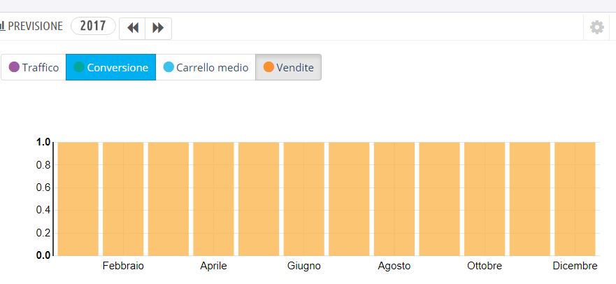

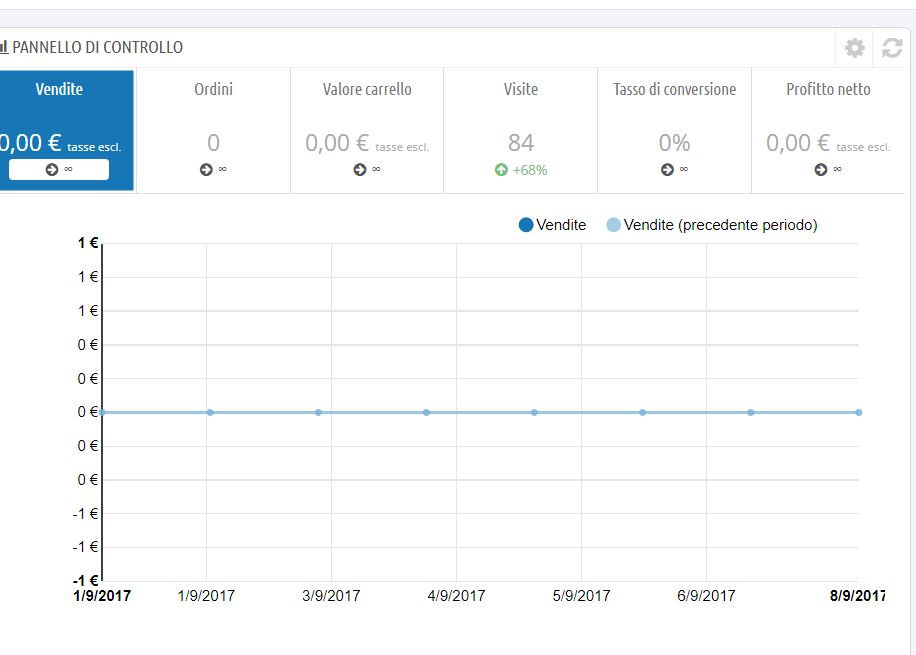

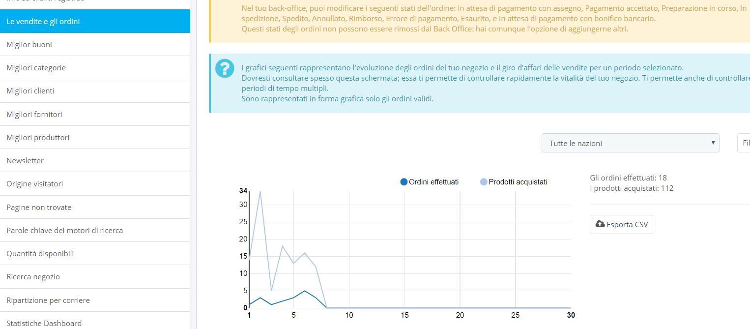

overbags Posted September 9, 2017 Share Posted September 9, 2017 (edited) Hello I just updated to version 1.6.1.17 and the stats in the control panel have disappeared. in the statistics module everything works fine only in the control panel do not work I attach some picture to make me understand better Edited October 23, 2017 by overbags (see edit history) Link to comment Share on other sites More sharing options...
