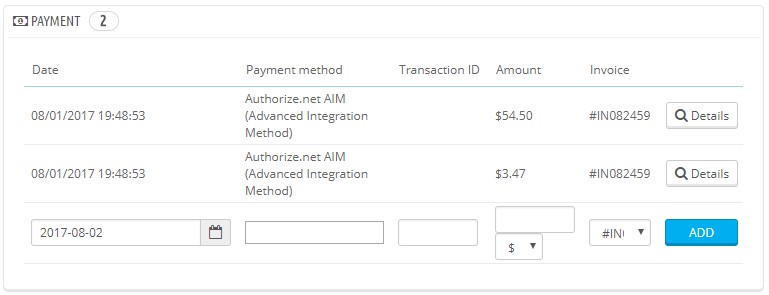

Prestashop is showing 2 payments for all orders that have the state sales tax on them.
The first payment is for the order itself, plus shipping.
The second payment is only for the state sales tax.
However, we are now finding that when we go into Authorize.NET, only the first charge is actually being processed and they are NOT even receiving the 2nd charge for the sales tax. So we have not been receiving ANY of the money for sales tax that Prestashop has been claiming to charge.

You can see the two payments listed on the attachment. However, only 1 payment actually came through our Gateway and the order is showing to be paid in full.
Can someone please advise on this?

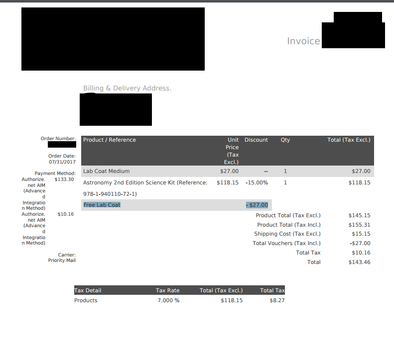

In digger a bit deeper on this, is PrestaShop able to actually handle sales tax? Here is an invoice that I couldn't be more confused over. Does anyone know if they have fixed these bugs in the recent updates? Are others having these bugs, and like us, haven't dug into the numbers deep enough to notice them yet?
Neither of the actual charges on the left correspond to ANYTHING on the right hand side of the screen.
1) Does anyone know why there are 2 different sales tax numbers listed on the invoice?
2) Does anyone know why it is attempting 2 separate transactions for payments? I'm pretty sure we "would" be getting charged doubly from Authorize.Net, "if" the charge for sales tax were actually going through.
3) Has anyone else had a similar experience to this?
