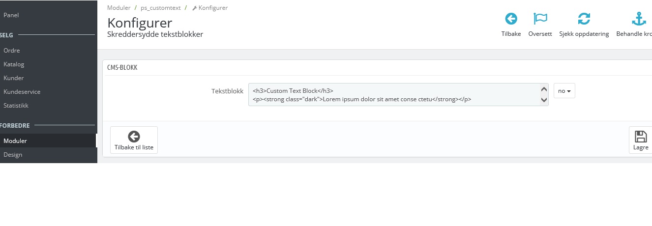

TrondAa Posted July 30, 2017 Share Posted July 30, 2017 (edited) Hi, I have just installed Prestashop v 1.7.1.2 with the demo version. Im now trying to change the custom text block, but as soon as I enter the module in backoffice the textbox disappear. I see the box for about 1 second and then it disappear. Please see attachment, because its easier to understand. Its in norwegian, but hopefully you guys will understand. I have tried both in explorer, chrome and firefox and all have been updated. I have also tried to reset the module. Any suggestions? The first attachment shows what it look likt the first second I enter the module, and the other attachment show how it looks when the textbox has gone.. Edited July 30, 2017 by TrondAa (see edit history) Link to comment Share on other sites More sharing options...

TrondAa Posted July 31, 2017 Author Share Posted July 31, 2017 (edited) In the console I have this: Is this what you are thinking of? Failed to load resource: the server responded with a status of 404 (Not Found) no.js Failed to load: http://s639489433.onlinehome.us/js/tiny_mce/langs/no.js VM124:2 What can I do to solve this? Edited July 31, 2017 by TrondAa (see edit history) Link to comment Share on other sites More sharing options...
NemoPS Posted July 31, 2017 Share Posted July 31, 2017 I believe the rich text editor is breaking, yeah, for norwegian it seems Link to comment Share on other sites More sharing options...
TrondAa Posted July 31, 2017 Author Share Posted July 31, 2017 So the problem is in the translation to Norwegian in Prestashop? Is there anything I can do to solve the problem? Link to comment Share on other sites More sharing options...

TrondAa Posted August 2, 2017 Author Share Posted August 2, 2017 Hi! Thanks for info. When I look at js/tiny_mce/langs/ folder there is actually no file with the name of no.js. So I guess the missing file is the problem? How do I get this file installed, or do I need to install prestashop again? Will this solve my problem? Link to comment Share on other sites More sharing options...
NemoPS Posted August 4, 2017 Share Posted August 4, 2017 If re-downloading the localization didn't help, I guess install prestashop on another server, or even locally. Set the language to norwegian, check that it works, then copy the file from there Link to comment Share on other sites More sharing options...
TrondAa Posted August 18, 2017 Author Share Posted August 18, 2017 Hi, I have tried to install the newest version 1.7.2 but there is still no no.js file. So I guess this file dosent exist at all. Is there a way to get around this problem? Modify another js file, make a new one?? Im new at this type of problem. Link to comment Share on other sites More sharing options...
NemoPS Posted August 19, 2017 Share Posted August 19, 2017 It might just be that prestashop 1.7 doesn't fully support norwegian. What if you reach the folder, clone any language.js file in there and name it no.js? like en.js if it's there 1 Link to comment Share on other sites More sharing options...
TrondAa Posted August 20, 2017 Author Share Posted August 20, 2017 Its working! I did what you said, and it seems that this solved my problem. Thanks for your help! 1 1 Link to comment Share on other sites More sharing options...
