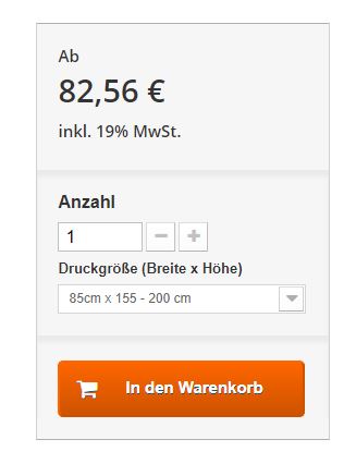

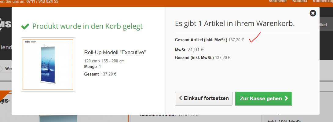

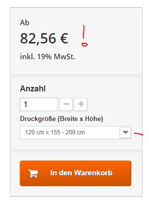

prime1974 Posted July 27, 2017 Share Posted July 27, 2017 Hi all.We are having a very important problem with our Prestashop 1.6.1.15 installation on which we are using two different online shops with the multistore functionality on two different domains. On our second store the price display on the product detail page for a product with different attributes is not updating, changing the product attribute at all. We made sure that all the price information for each attribute is well set and working in the backend. It seems interesting, that the product price is calculated correctly, once the product is added to the cart. The functionality is working well on our first (base) store. Please see a typical product working well. We made also sure that the id for "our_price_display" is correctly set in the price display, using a css modified standard theme. Please see the screenshots to visualize the problem. We are using: Prestashop 1.6.1.15 with typical module set, except: - Pretty URLs - Dynamic Product Price - Prestashop Customer Files Upload (MyPresta.eu) Link to comment Share on other sites More sharing options...

exiang Posted November 7, 2018 Share Posted November 7, 2018 I not sure who coded it this way, but it has something to do with memcache server and seo url I faced the same problem after I changed the seo url from {id}_{slug} to {slug}_{id}. Then, whatever i do with the product price is not reflect in frontend. Then I found out I need to clear my memcache by restarting it, then it works. Probably caching is base on url, it should be by product id. Link to comment Share on other sites More sharing options...
