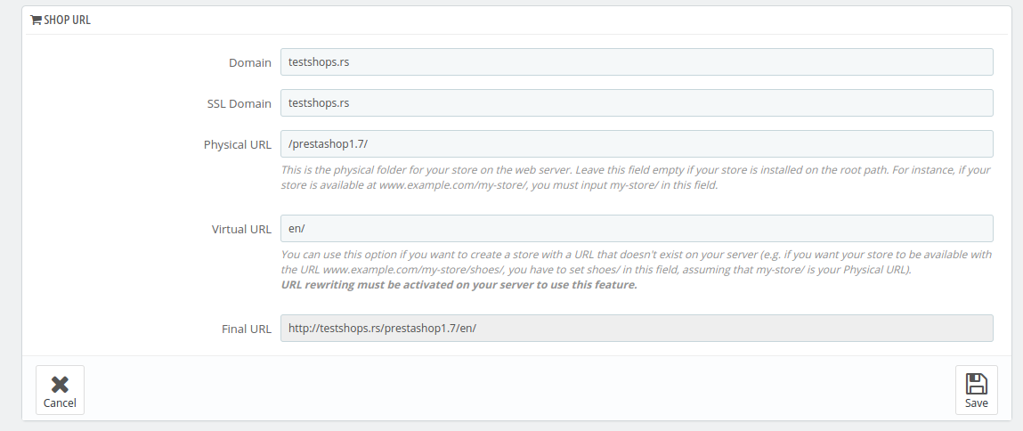

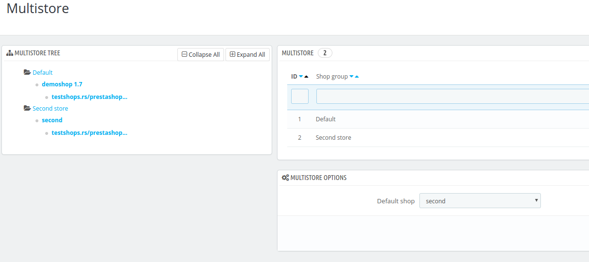

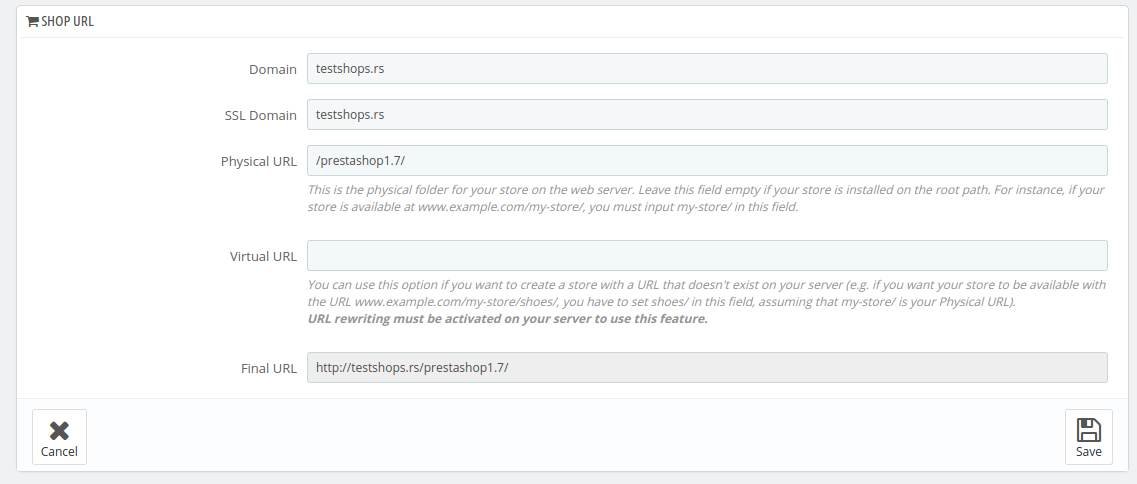

Then, I enabled multistore option and added additional shop group called "Second", added one store to it and made it default:
Store settings are here:
Settings for store "demoshop 1.7":
Settings for store "second":
With this setup, from backend controller I got this link:
http://testshops.rs/prestashop1.7/en/module/cleverreach/auth
This URL works properly and links to my controller. But when I use the same code from this frontend controller ("auth"), I get this link:
http://testshops.rs/prestashop1.7/en/en/module/cleverreach/auth
Note that "/en" prefix is added twice. This link also works but it creates a problem for external system that uses it because those 2 links do not match.

I checked context object and shop and with this setup, backend is returning "second" for context->shop, and frontend is returning "demoshop 1.7", which probably causes the error. The main problem is that with this setup (enabled multistore, set second store as default and then disabled multistore) I cannot manage to get the same link anyhow.
