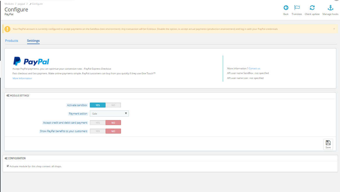

Steigensoft Posted July 22, 2017 Share Posted July 22, 2017 Hi, I have this specific problem wherein I cannot configure PayPal credentials/api keys. The backend module configuration form blindly redirects to PayPal site. Its totally frustrating. Is there some kind of step that we are missing in here. Link to comment Share on other sites More sharing options...

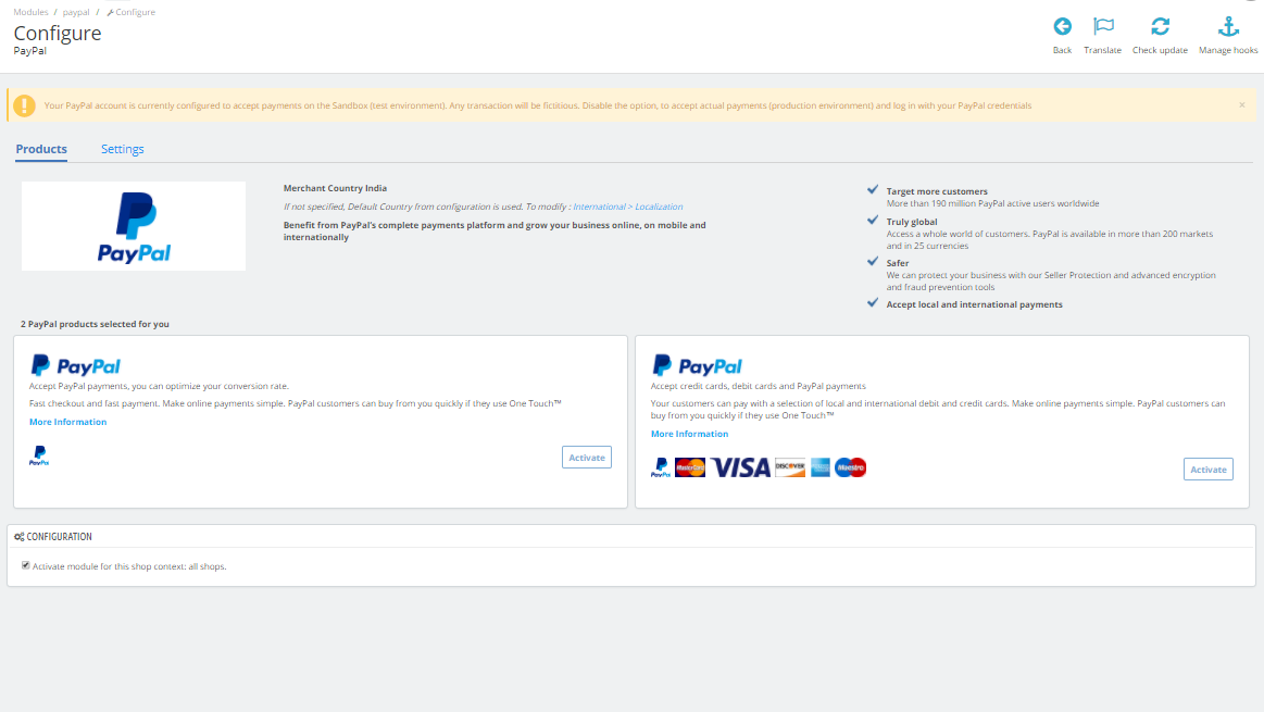

bellini13 Posted July 24, 2017 Share Posted July 24, 2017 It does look like they have refactored the configuration page. If I put the module into sandbox mode (settings tab) and then save, and then click on one of the Activate buttons, I get redirected to the Paypal sandbox register merchant account flow https://www.sandbox.paypal.com/US/merchantsignup/partner/applicationChecklist?productIntentId=additional_payment&channelId=partner It assumes I do not already have an account and it wants me to register I reviewed the remainder of the modules code and I cannot find anywhere that it would allow you to enter any existing account information. Another 'well done job' by Prestashop and its 'official' module team Link to comment Share on other sites More sharing options...

TC!! Posted August 18, 2017 Share Posted August 18, 2017 I'm having the same problem, the previous version of PayPal worked fine but the upgrade has broken it. I was able to get a bit further than what you've posted. When you click 'Activate' for the PayPal product you want it takes you to a sandbox.paypal.com address. If you then enter one of your sandbox email addresses, e.g. something-facilitator.yourdomain.com, it then takes you to another page with your main PayPal email address filled in and asks for a password. That's where I'm stuck, it doesn't work no matter what password I enter and the password reminder option tells me there is an error even though I can use that email address to log into developer.paypal.com with no problem. I tried to get around this by entering the API details directly in the ps_configuration database table of prestashop but the settings page in the paypal module still says API details are not specified. I have a customer who is losing their patience as this was working and now it's broken. Link to comment Share on other sites More sharing options...
TC!! Posted August 23, 2017 Share Posted August 23, 2017 I've tried to work through this problem with PayPal and they're putting ht blame squarely on PrestaShop, here is their reply after I sent them screenshots of what I'm seeing: Thanks for the screenshots. I am not sure why Prestashop links you to Sandbox. As far as I know it should link you to the live account. If it is linking to Sandbox obviously you have to provide the Sandbox password but I think there is something wrong in the link in Prestashop. You should check with them as this is a procedure to activate their module on their platform, I don't know what the procedure exactly needs to perform. I thought it was something related to the password for your account but looks like their procedure having a wrong link or configuration. Here you can find the link to your eCommerce online forum where you can eventually find other customers that had the same inquiry and found a solution for that: https://www.prestashop.com/forums/ Link to comment Share on other sites More sharing options...
TC!! Posted August 23, 2017 Share Posted August 23, 2017 The response from PayPal gave me the solution, turn off sandbox. If you turn off sandbox and then click on activate you can log onto PayPal with your normal PayPal account and then give permission for Prestashop. This only helps if you are ready to go live and switching back to sandbox after doing this tries to take you back through the sandbox activation which doesn't work. Link to comment Share on other sites More sharing options...

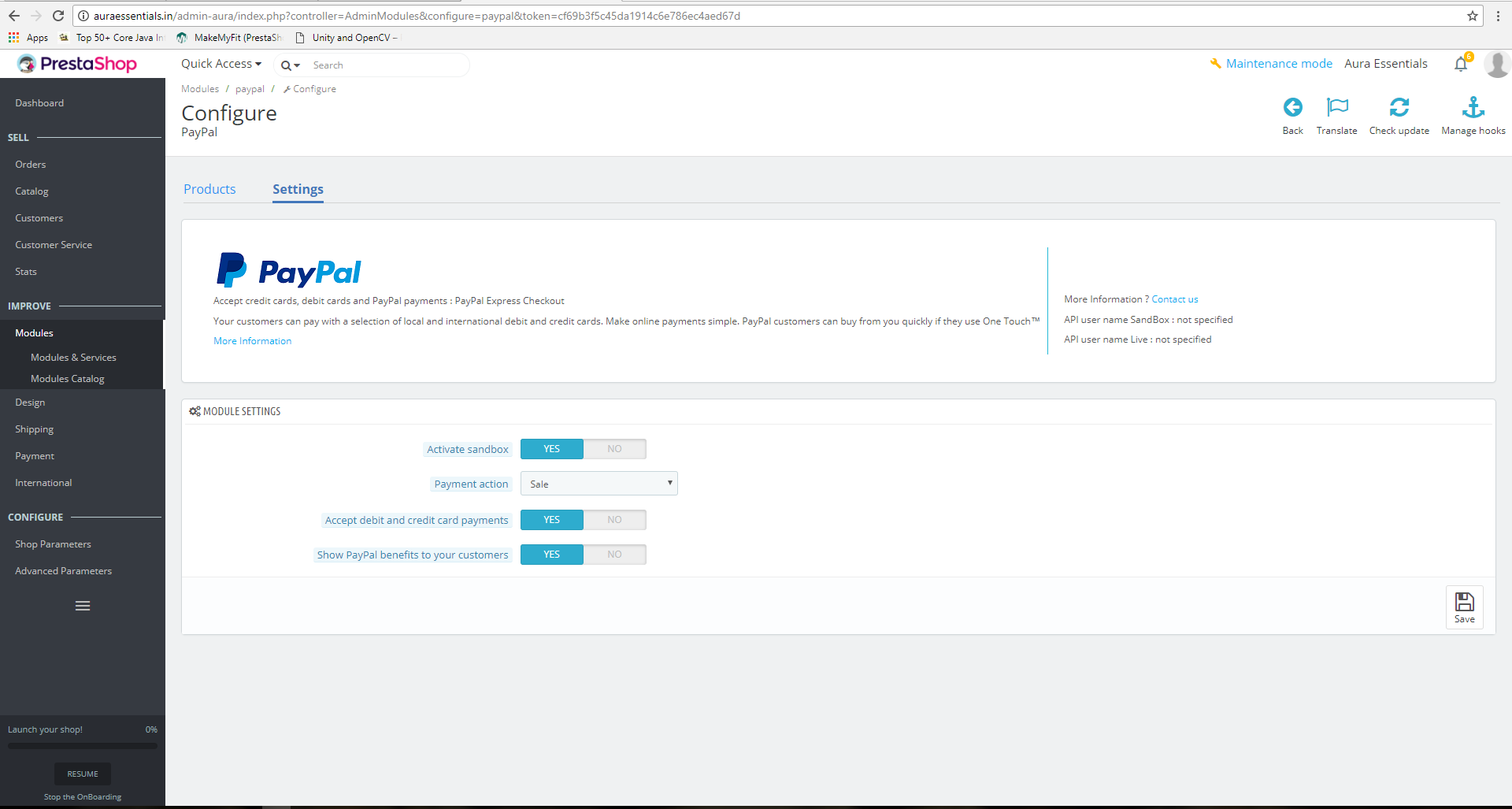

Kaushal Sachan Posted March 30, 2018 Share Posted March 30, 2018 I have same issue on Prestashop Backend. there is no option to put paypal soap/API credentials. Link to comment Share on other sites More sharing options...
