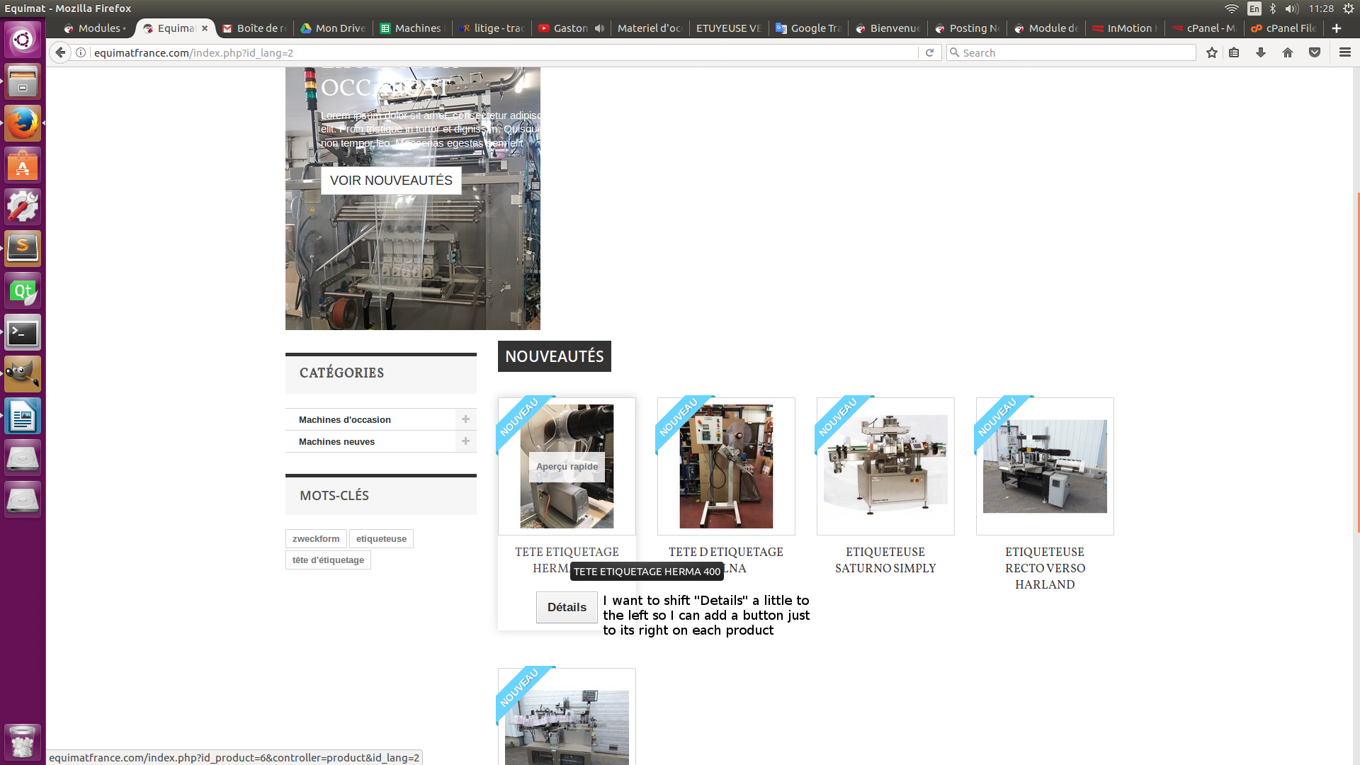

joan-coquelin Posted July 4, 2017 Share Posted July 4, 2017 (edited) Hello, First sorry if I am not posting at the right place I am very new to prestashop. Here is my problem and I would like to thank in advance each and everyone of you for trying to help me. I have a catalog I would like that when the visitors of my website hover my products they not only have access to a button "details" but also a button "Get a quote" that would be linked to a custom form. From my research it seems I have to create my custom CMS page for the form which I should be able to manage. Now my question is, how can I add this button there please ? Thank you very much, Joan Edited July 4, 2017 by joan-coquelin (see edit history) Link to comment Share on other sites More sharing options...

joan-coquelin Posted July 5, 2017 Author Share Posted July 5, 2017 Hi, Thank you both very much for your answer. If I get it right I edit product-list.tpl and product.tpl to add a button, from there I can point to a custom CMS page that would be my form. Now I have two questions : how do I "pass" for example, the name of the product on which the button was, to the form how can I run a script after clicking the button "Request a quote" from the form Understand I am a programmer but absolutely not a web developer. So you can assume I understand programming terminology and stuff but at the same time I know nothing as how to do that kind of things. With that in mind would any one of you be kind enough to guide me a little more. Thank you once again ! Joan Link to comment Share on other sites More sharing options...
Scully Posted July 5, 2017 Share Posted July 5, 2017 (edited) I would recommend not to create an addditional form but instead use the default contact form. You can pass parameters there like this: http://example.com/contact-us?message=request quote ... where message is the field name of the long free text field in the contact form. Translated into product.tpl, it would loke something like this around line 100 and following: Only the middle line with getPageLink is new. The other two lines just illustrate the place where I have put this in. </div> <!-- end image-block --> <h3><a href="{$link->getPageLink('contact', true)|escape:'html'}?message={l s='I request a quote for:'} {$product->name|escape:'html':'UTF-8'}" title="{l s='Request quote'}" rel="nofollow">{l s='Request your quote'}</a></h3> {if isset($images) && count($images) > 0} And the result: A new large Link which points to the contact form and the product name is already filled in like this: I request a quote for Product XYZ. Tested on prestashop 1.6.1.13. Edited July 5, 2017 by Scully (see edit history) Link to comment Share on other sites More sharing options...
