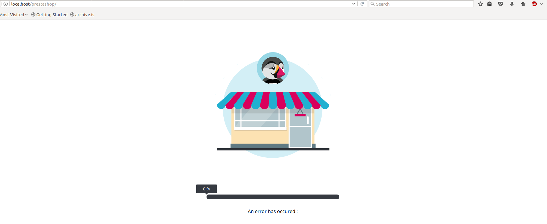

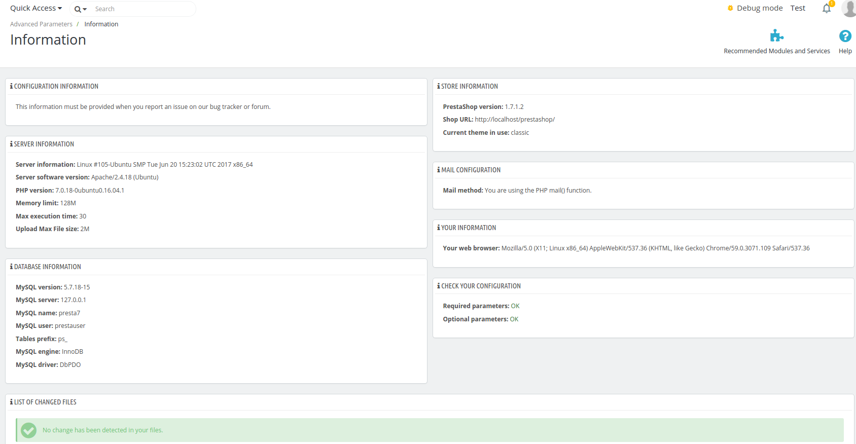

bvelichkov Posted June 24, 2017 Share Posted June 24, 2017 Hi guys, just installed and configured Prestashop 1.7.1.2 ( latest at the moment ). When I try to access the front office, the screen blanks and says "An error has occured : " without any further explanation. In the attached images you can see the config from the back office and the error in the front. Just to be clear - there are no any kind of errors ( related to this or not ) anywhere in the log files.Any ideas? Thanks in advance! Link to comment Share on other sites More sharing options...

bvelichkov Posted June 25, 2017 Author Share Posted June 25, 2017 Please try to enable DEV mode by setting _SP_MOD_DEV_ to true in following file /config/defines.inc.php You should see more detailed error messages in DEV mode, so you will know where is the problem. Hi shokinro, I already have tried this. As you can see in the screenshot from backoffice it is already in debug mode (top right). in defines.inc file the situation is : if (!defined('_PS_MODE_DEV_')) { define('_PS_MODE_DEV_', true); } No use, still the same behavior. Link to comment Share on other sites More sharing options...
