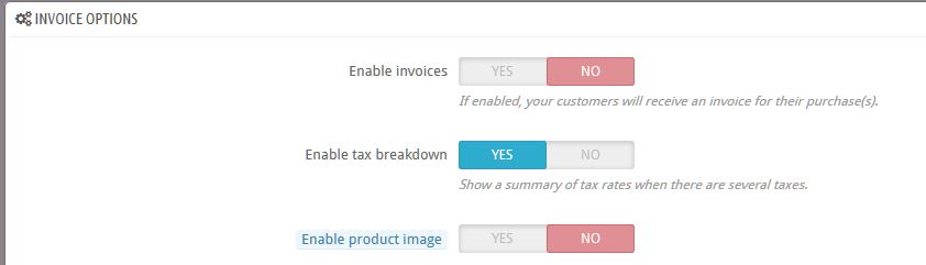

FPA Posted June 15, 2017 Share Posted June 15, 2017 Just noticed that the invoices are disabled as the customers are complaining about not getting them. Checking Orders > Invoices I noticed that "Enable Invoices" is set to : No. Activating it doesn't work. It shows Enabled but as soon as I change tab and back again on invoices, it's back to No as you see on the screen capture attached. I can generate old invoices manually, but only up to June 2nd. Clearing the cache and using different browsers doesn't help. Our PS has been updated today to 1.6.1.14 I'll highly appreciate your help chaps ! Link to comment Share on other sites More sharing options...

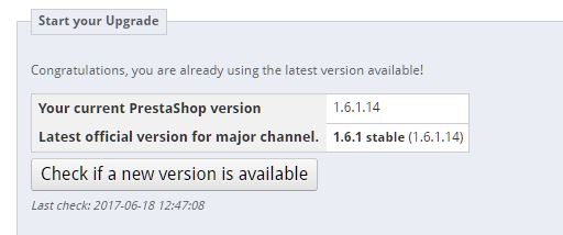

FPA Posted June 18, 2017 Author Share Posted June 18, 2017 Exactly. The database table of the multicurrency module is fixed now. But our invoice issue is apparently not related to the module issue ! Looks like we are back to start again ... To reply to your question Shokinro, I didn't install any module since 3 months now. Just upgraded from 1.6.1.13 to 1.6.1.14 and that the latest version I get on 1 click upgrade screen capture attached. Link to comment Share on other sites More sharing options...
