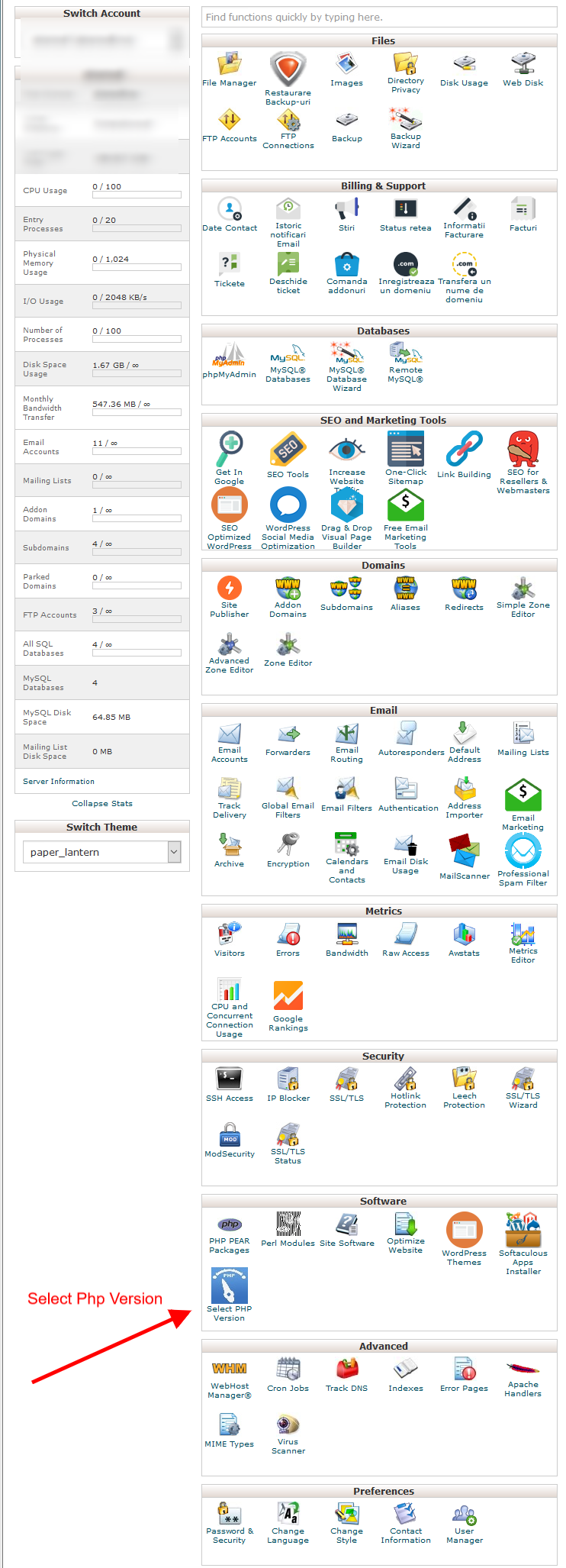

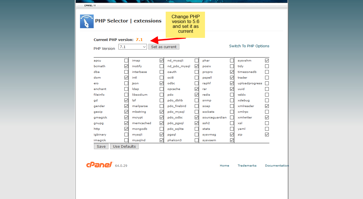

Deostar.ro Posted July 4, 2017 Share Posted July 4, 2017 (edited) Hello, THIS PROBLEM IS SOLVED. SEE BELOW When trying to update the shop using 1 Click Update module I encountered numerous times this kind of error: " errorThrown:"Internal Server Error " jqXHR: " " After many trials and errors I discovered that the this error was triggered by 1 Click Update module for PS 1.6 (the last version available for this module as of today is 1.6.7), which is not being capable of working properly (i.e it hangs on database update, yet manages to update all files) on PHP 7.1. I tested numerous times. The 1 click update module version 1.6.7 works flawlessly on PHP 5.5, PHP 5.6 and, to my surprise, even on PHP 7.0. And as I said before, it hangs when working on PHP 7.1 And a lot of people are using PHP 7.1 today, even they do not know it (webhosts have upgraded overnight without notice, from PHP 7.0) Workaround /Solution If you are on Cpanel, and you have a good host, that permits "Select PHP version" button to appear in Cpanel, go to "Select PHP version" button (see attached screnshots), then enable PHP 5.6 with default options (works definitely) and only after that run 1 Click Update module. (If you do not see the Select PHP Version button, just email your webhost. It's as simple as 2 clicks for them to allow it on your Cpanel.) In order for this trick to work, please pay attention that you have the same modules enabled in PHP 5.6 that you have enabled in PHP 7.1, otherwise you will only see a blank page. Just write down the modules you have enabled in PHP 7.1 and enable the same modules in PHP 5.6. Of course it is wise to make a backup before....using PhpMyAdmin and Filezilla. You have really good chances to have a smooth and fine update, with everything in order after the upgrade. After the update, revert to using PHP 7.1 (no need to put shop in maintenance mode) in order to benefit from the speed and caching options PHP 7.1 offers. This solution will work 100% even when someone already tried to update and received the " errorThrown:"Internal Server Error " jqXHR: " " error. if you change the PHP version to 5.6 and then try to update again (after the error appeared) you will succeed with the update and your problems will be solved. Hope that helps some people in need. Edited July 9, 2017 by Vitamina A (see edit history) 1 Link to comment Share on other sites More sharing options...

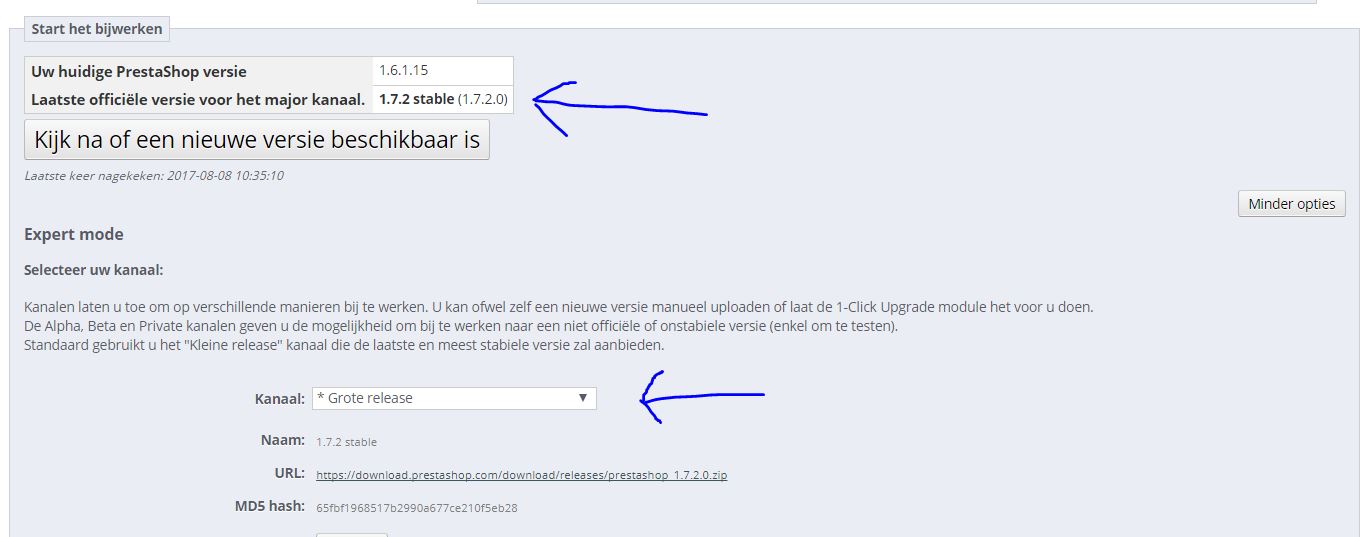

racemaniac Posted August 8, 2017 Share Posted August 8, 2017 (edited) Appears fixed in 1.6.16. I'm running 1.6.1.15 right now. with 1 click upgrade 1.67 I can only upgrade to 1.7.2 how do I configure to update to 1.6.1.16 ?? and then upgrade to 1.7.2 tnx Edited August 8, 2017 by racemaniac (see edit history) Link to comment Share on other sites More sharing options...
